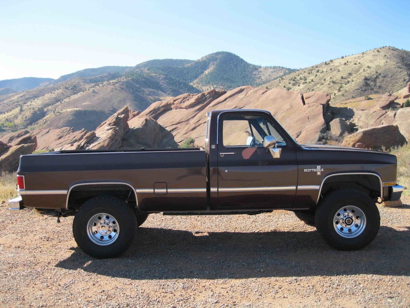

Just sold my previous 1983 K20 so I'm suffering from pickup withdrawal.
