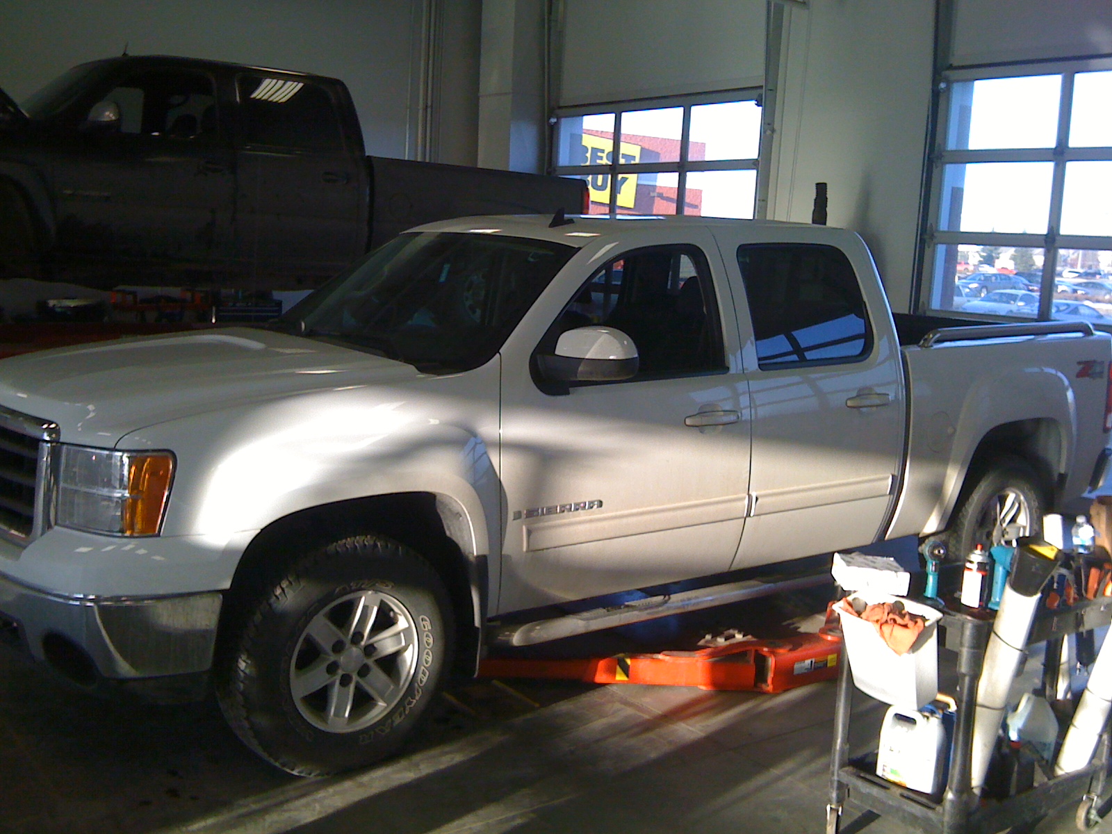

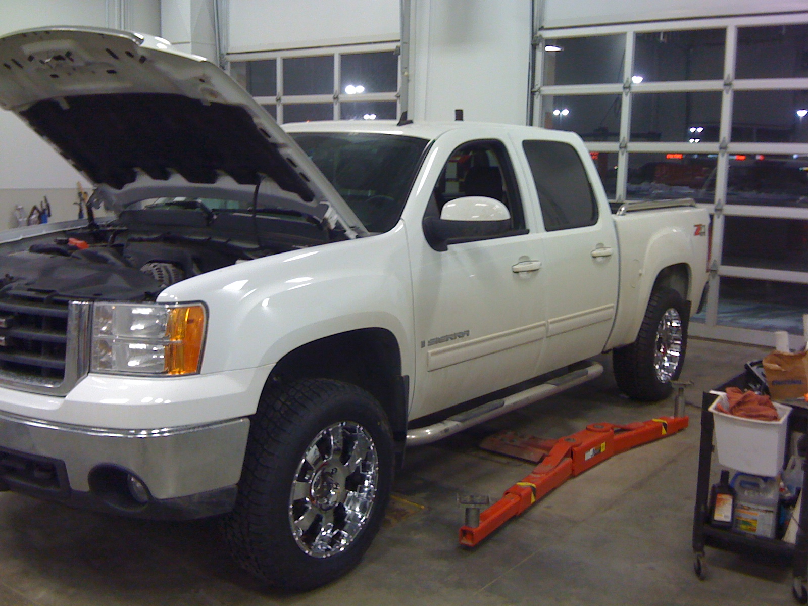

275/60r20 w/ 2.5in Level & 20x9 0mm Offset. Im pretty sure this will work without having to trim a little metal. Anyone running a setup like this. If i have to trim a little thats fine or I will just get a body lift. Let me know what you think, Ill be ordering wheels on Mon. They are going on an 07 new body style...
Try it and let us know.. if it doesnt clear you might need to go to a 1.5" body lift but i doubt it.
those wheels are going to stick out of your wheel wells a fair ways cause of the zero offset. +18 to 20 will sit flush with the fenders on a 9" wide wheel. just a heads up.
Tuesday Night I will be installing it all... Ill take pics when I get done and Ill try and post them by Wed. I did test fit the wheel the other day and it stuck out about a 1/2 to 3/4 of an inch from the front fender without a tire mounted on it yet...
Got it installed, I will post pics by this weekend I have just been stupid busy. It does rub a little but I still have factory mud flaps. I will remove those and see what happens tomorrow. Check back this weekend for pics...
