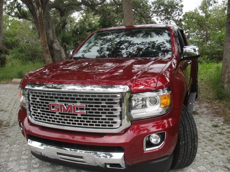

I have a 2017 Canyon Denali that I'd like to put the Clear View mirrors on my truck and the dealer ship wont tell me if ot's pre wired for tows with turn signals . My rpo code says there dl9's and I cant locate any info on how to wire them if not plug and play . Has any one done this to their Canyon Denali ?? Thanks !!!!
It seems like everyone is in the dark about tow mirrors tor my 2017 Canyon Denali !!  Is there another site that is more informative ??
I BIT the bullet and ordered a set of the Clear View mirrors with the turn signal lighting ! If I can't wire them for the signals does any one know of some one that can do it ??  I live in Clearwater Fl but willing to travel a few miles !!!
