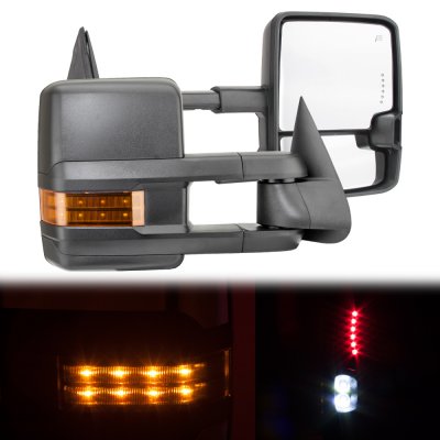

I have a 2017 1500 that I've been wanting to put towing mirrors on.. I took my truck to the dealer to see if they are plug-n-play.. They said that the driver mirror would be but that the passenger mirror would need an additional harness, they said they could install them for a mere $1,500. (mirrors: $650+labor) Idk where they get off saying $800 to install..
I currently have the Z71 color matching mirrors and would like my mirrors to match as well, but I can only find solid black or chrome. I am going to look into having the mirrors painted, If I didn't need an additional wiring harness I would do this myself to avoid invalidating my warranty.
I currently have heated and pwr operated, but not pwr folding. I don't need power folding but would like the luxury of the reverse lights, blinker, entrance and heated options. does anyone know for sure if i need additional harnesses or if they're just trying to make a buck?
These are the mirrors i would like, in Deep Ocean Blue:
