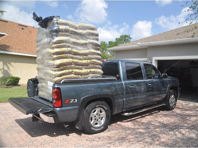

Hey all,
Trying to figure out what is up with my truck. A few weeks back, Lowe's had a sale on mulch and my neighbor asked if I could help him get some. They loaded a full pallet of the red mulch in my truck bringing the rear end all the way down. I drove the 10 miles home slowly, but my leafs were as flat as you can get. I then decided that the deal was too good to pass up so I picked up two more pallets for a total of three trips. I then loaded it this week with 2x4s 4x4s for a fence I'm building. It was only 20 green treated 8 foot posts and 60 2x4s and I was down on the bump stops again!
The tires have about 65k miles and will be replaced soon. They drove smooth prior to all of this hauling, but a couple weeks back, I had them balanced and rotated. Now, I feel every contour of the road. The rear end seems to bounce a lot. It feels as if the tires are overinflated and there is no give to them. I checked the air pressure and that's fine. I took the truck back for the tires and found they were still out of balance, so had that fixed. Not sure if my tires are shot or if I damaged the shocks/springs with overloading.
How can I tell? I guess it might be time for some airbags!!!!

good god son, i would say you def put the payload to work. you prob damaged the leaf springs if anyting. if you have the time unbolt your rear shocks and see how much pressure they still have on them. also whens the last time you had your shocks replaced? your load you did might just have sent the shocks to the limit
Dude, check to see if there is any fluid leaking out of your shocks. I dont think your leafs are damaged, but the shocks are most likely shot.

holy shit..... id have to say you have bigger balls then me to haul a load that much higher above the cab!! :cheers:

I checked the shocks and don't see any fluid on them. I also used the old fashioned "bounce" method on the rear bumper. There was a little movement, but it was about the same amount as a friends Avalanche with 60k miles on it with factory shocks. I guess I needed a baseline, but never made one. I'm also questioning the life of a front shock so I will call Bilstein tomorrow and see what they have to say about testing their shocks.
I know that the springs will sag when they get weak and my truck sits level still so if anything, they might need replacing due to age, not because of my overloading. I'm thinking shocks might have gotten damaged or the tires are just worn enough that the front tires, now on the rear, feel different on the rear than they did up front. Again, the feel is like the tires are overinflated, not soft.
