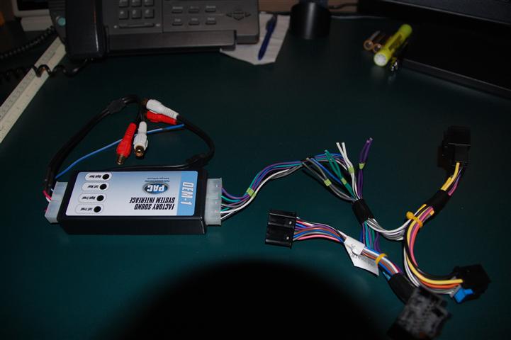

Here are a couple pic's of the PAC harness after the cuts , if I can get them to post....
the rca's go to the amp from the PAC module and the 4 sets of cut wire are where the sound ties back into the PAC harness from the sound out on the amp

Thanks for the great detail!
