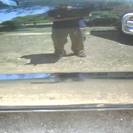

i used 3m spray on adheisive remover and give me a sec to upload these photos its super sunny outside so i dont know how well you'll be able to see the bad spots but there is a pic of the whole truck to show what color everything should be. figured that may help a little
I might polish out but you will need to be VERY careful because of its position. Appears you let the adhesive remover on a bit toooo long.
A buffer maybe,,,,,,,, a polisher NO.... Its on a curve... It is going to make burn trough very easy.

took ALOT of elbow grease and product but it all came off and looks good thanks for the advise
