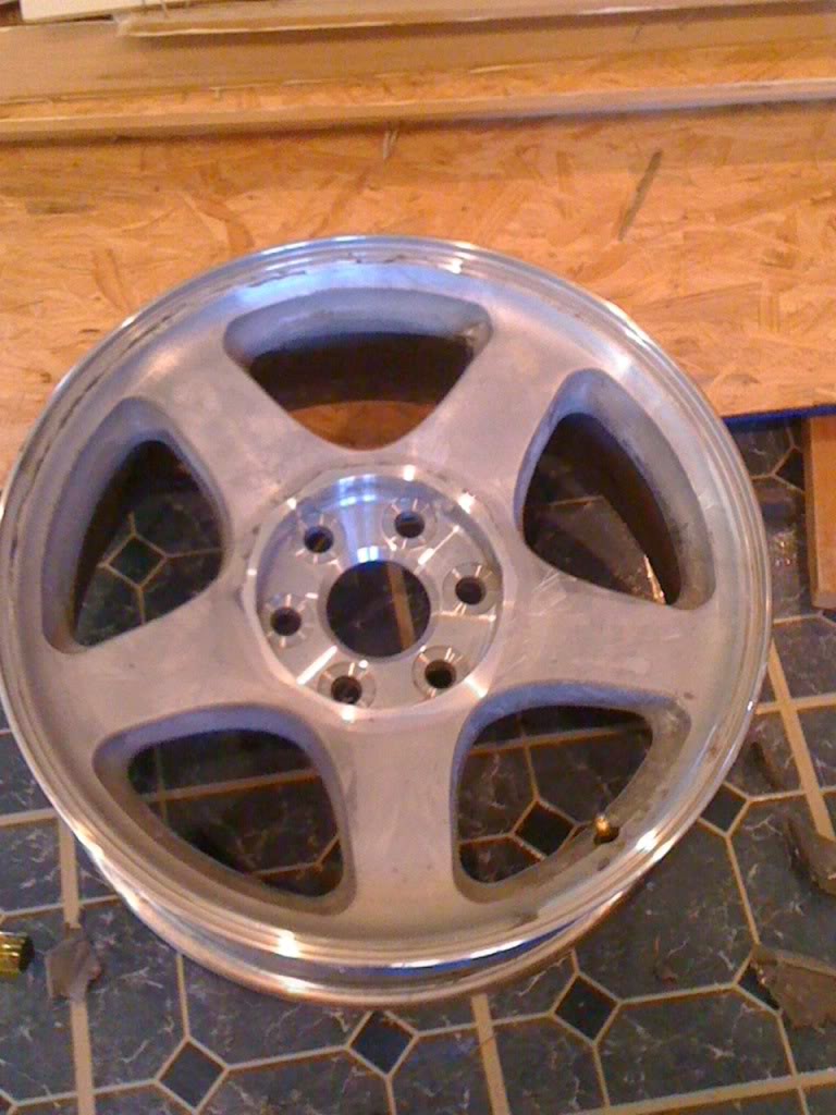

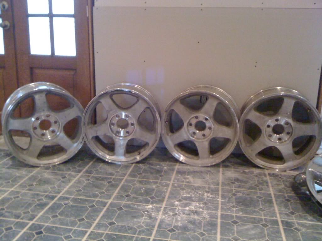

Can you take the clad off? And if so, what does the wheel look like behind it? Paintable?
I guess you could take the plastic off,I just have no idea what it looks like under there.

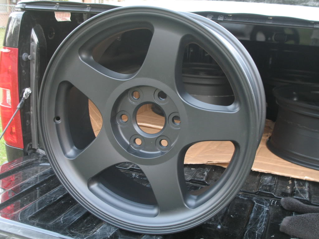

Those look great!
Are these the chrome clad whels with the plastic removed? I wasn't able to view the pics on the other forum for some reason. If so, GM should use these as the OEM wheels and not the chrome clad ones.

Those look great!
If these were chrome, could you not use the center caps from the original wheels?
Yes they are. The link above tell how to take the plastic off. The only thing that might not quite look exact is the center cap. Im sure someone will figure that out soon.
