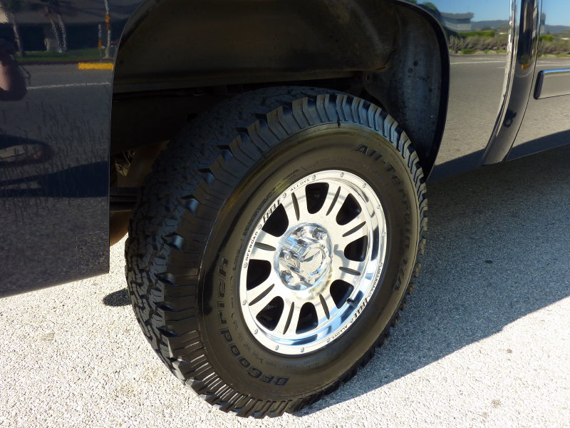

I recently had new tires and wheels installed and although I'm not someone who frequently posts on websites, I thought I'd share my experience because I really appreciate all of the info I found from everyone on here.

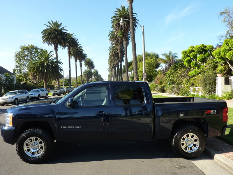

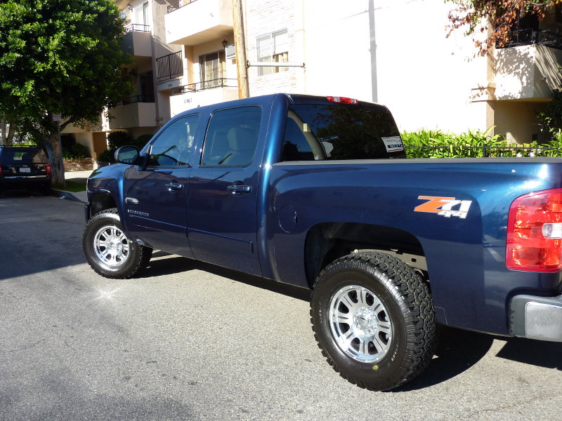

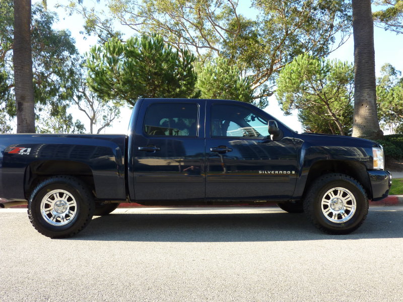

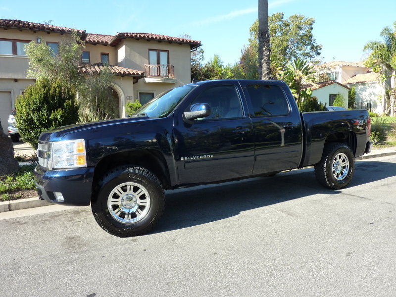

Here is my setup on my 2007 NNBS Silverado 4x4 Z71 LTZ. I like the beefier look of more tire and less wheel, so that's why I chose 17's.

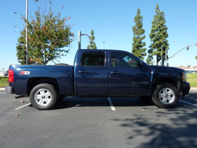

Before:
Stock 265/65/18 Bridgestone Duelers
After:
2" RC leveling kit

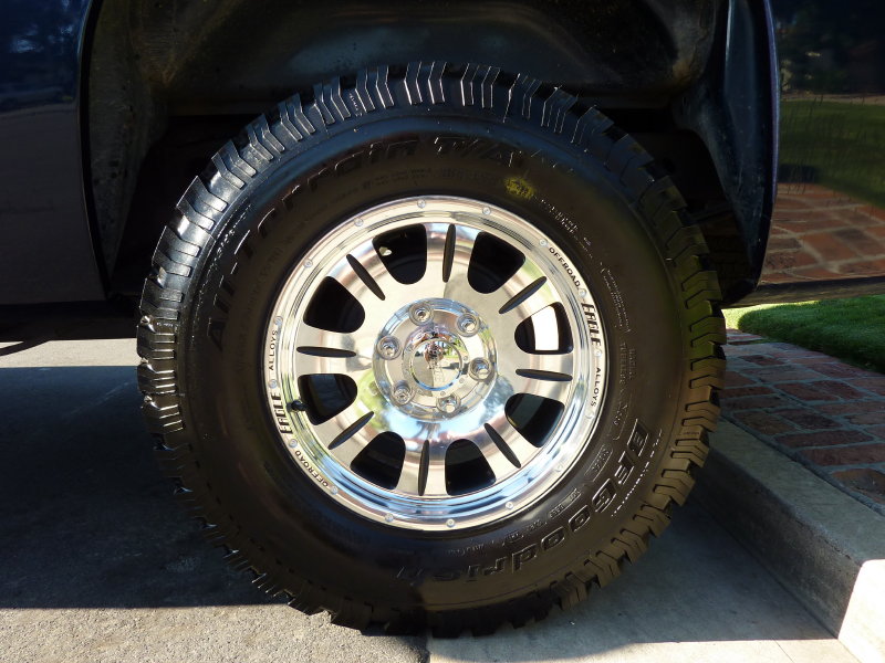

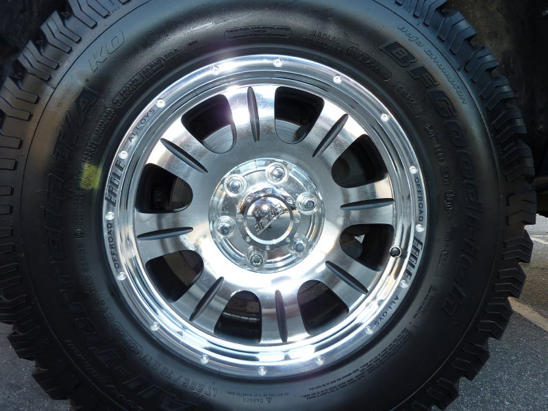

Eagle 140 Superfinish wheels 17x8, +2 offset, 4.6" backspacing
285/70/17 BFG T/A KO tires

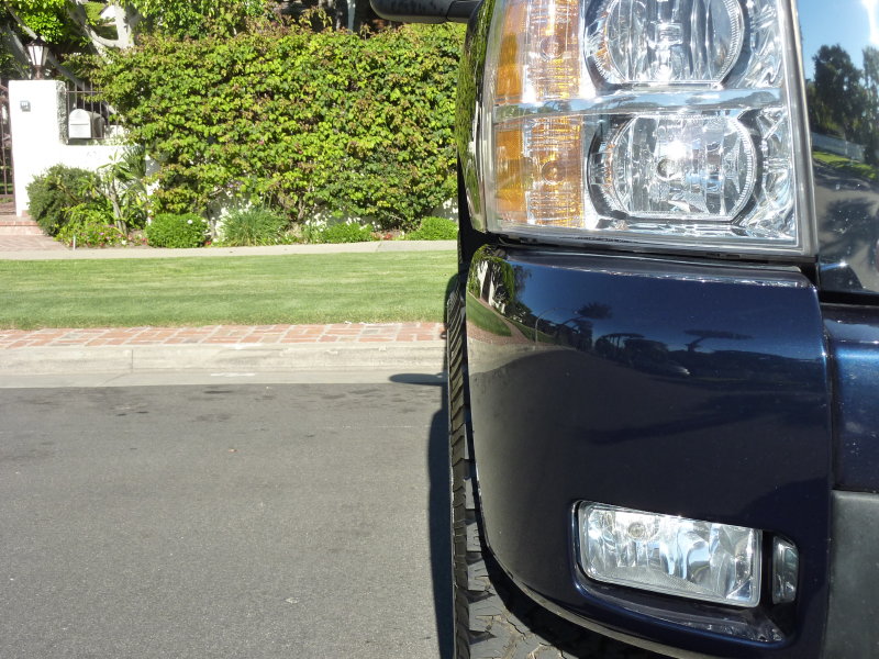

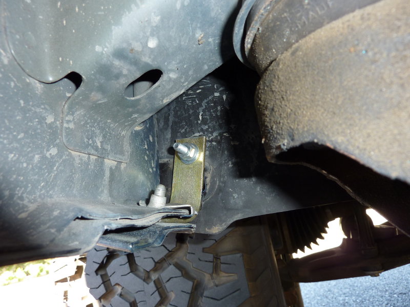

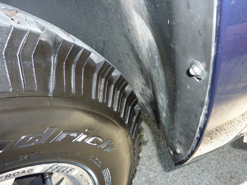

And yes, they rubbed, but thanks to you guys, I was prepared for this! Not significantly, but I didn't want any rubbing. So I took it to 4 Wheel Parts Performance center in Redondo Beach, CA and they trimmed the fender for me. Took about an hour and $100 and you can't even tell it was modified unless you climb under the truck.
After cutting the edge of the fender, they attached a little bracket to the bottom of the fender and the original hole in the fender liner to pull back the liner about 2". The liner was not cut at all.
Pics are attached. Feel free to call them and ask more more info about how they did it. I'm happy with the way it looks. Bottom line: Dont be intimitated about having the fender cut. It was easy for them to do.
The trimming: From behind tire on drivers side
