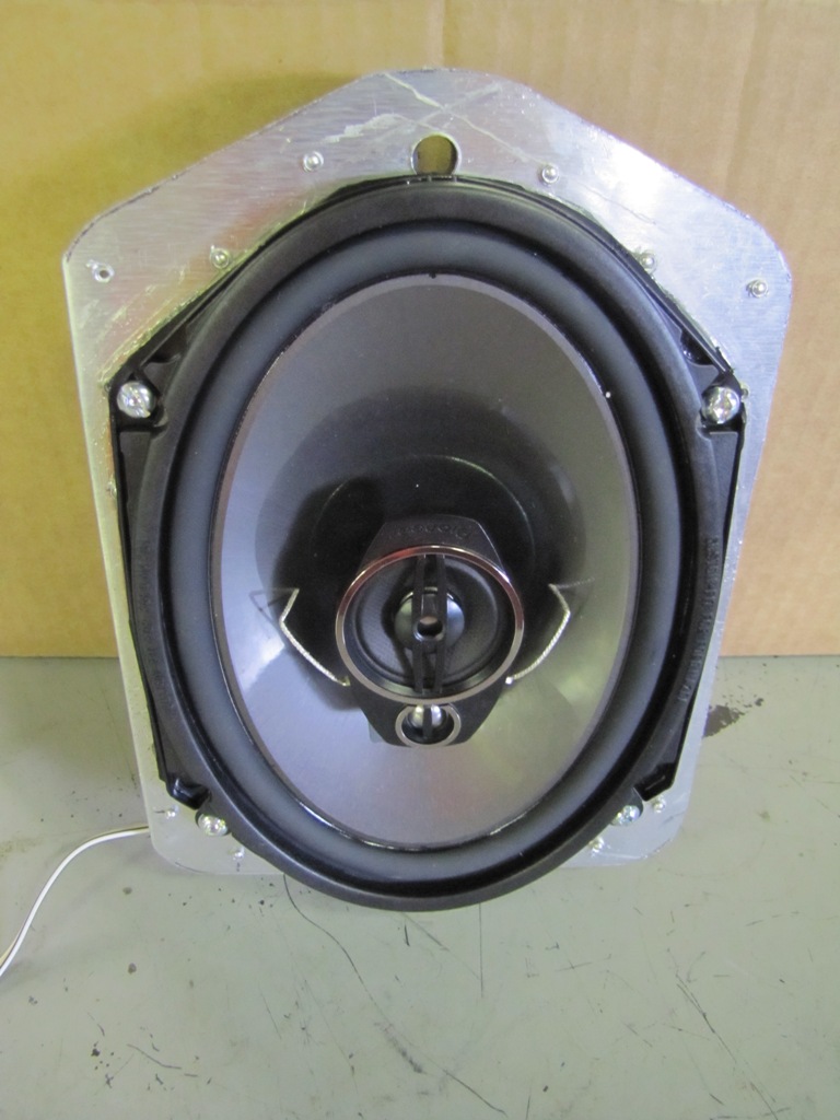

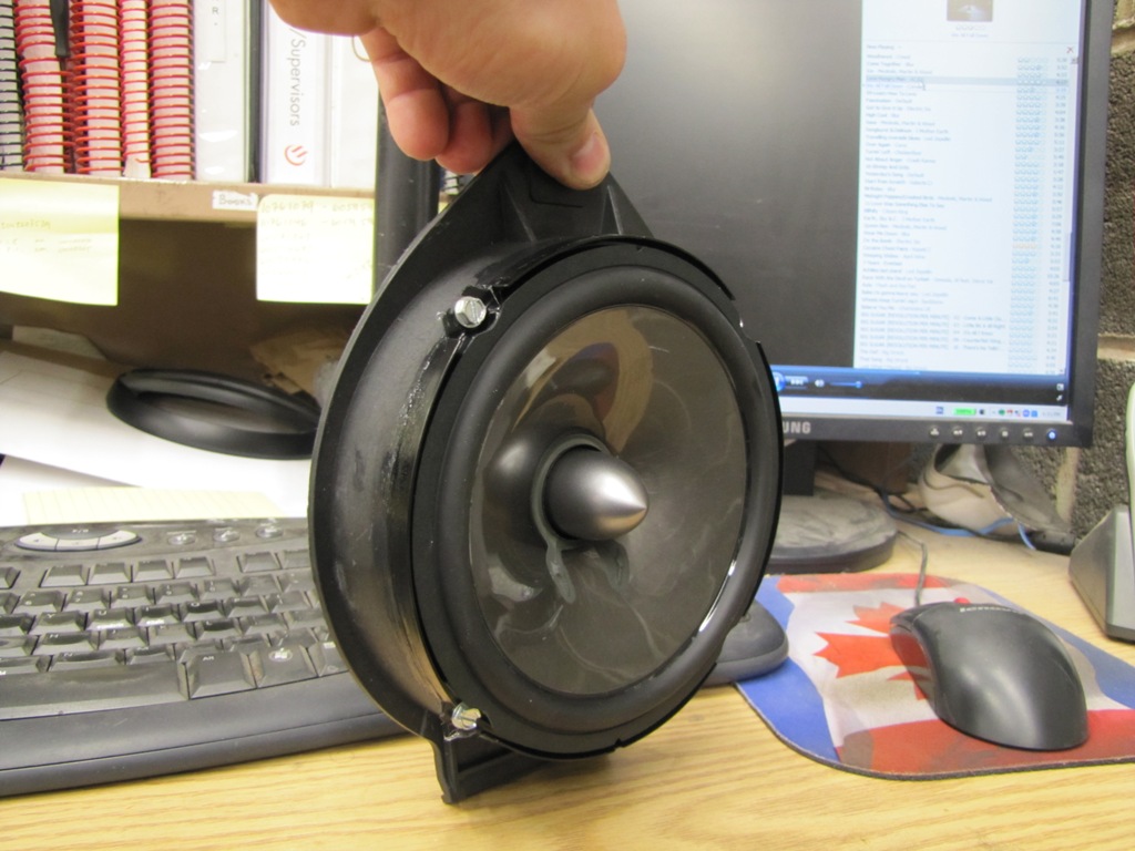

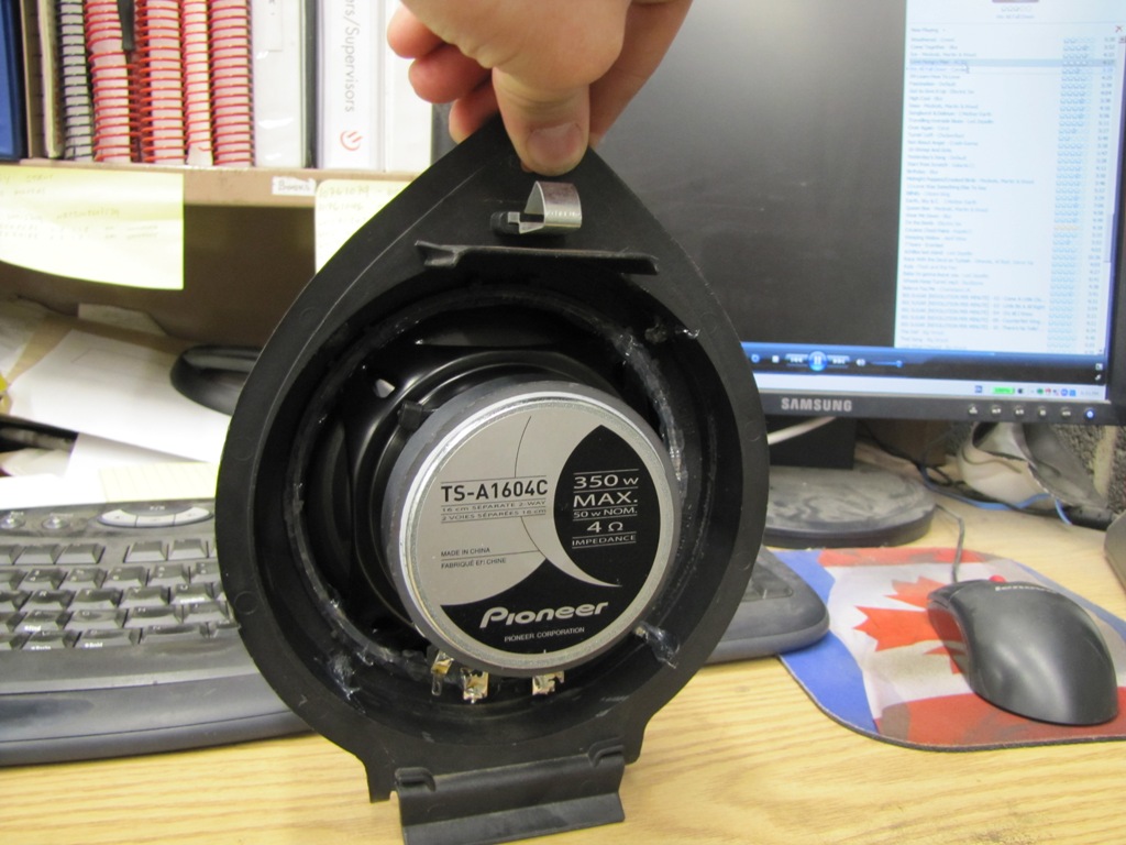

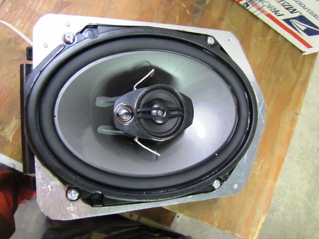

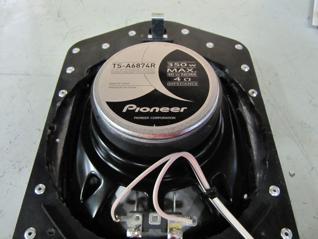

2011 Sierra 1500 Extended cab. Here are pictures of the brackets I just made for mine.
Front - 6.5
Rear - 6X8
I modified the factory brackets. The rear ones were the most work. I spent about 2 hours with the dremel. This left hardly any plastic left, so I rivited a 3/16 aluminum plate over top of it for strength, then siliconed the 2 together. The 6X8 speaker just barely fit. There is also a piece of rubber measuring about 3/16 between the aluminum plate and the speaker itself. If I had to do it again I would have made the aluminum plate about 1" longer to extent past to bottom of the plastic bracket.
Cheers, Brendan

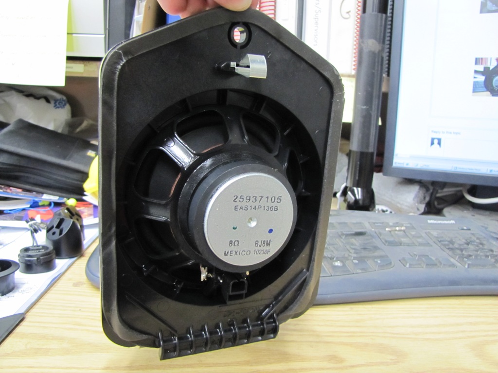

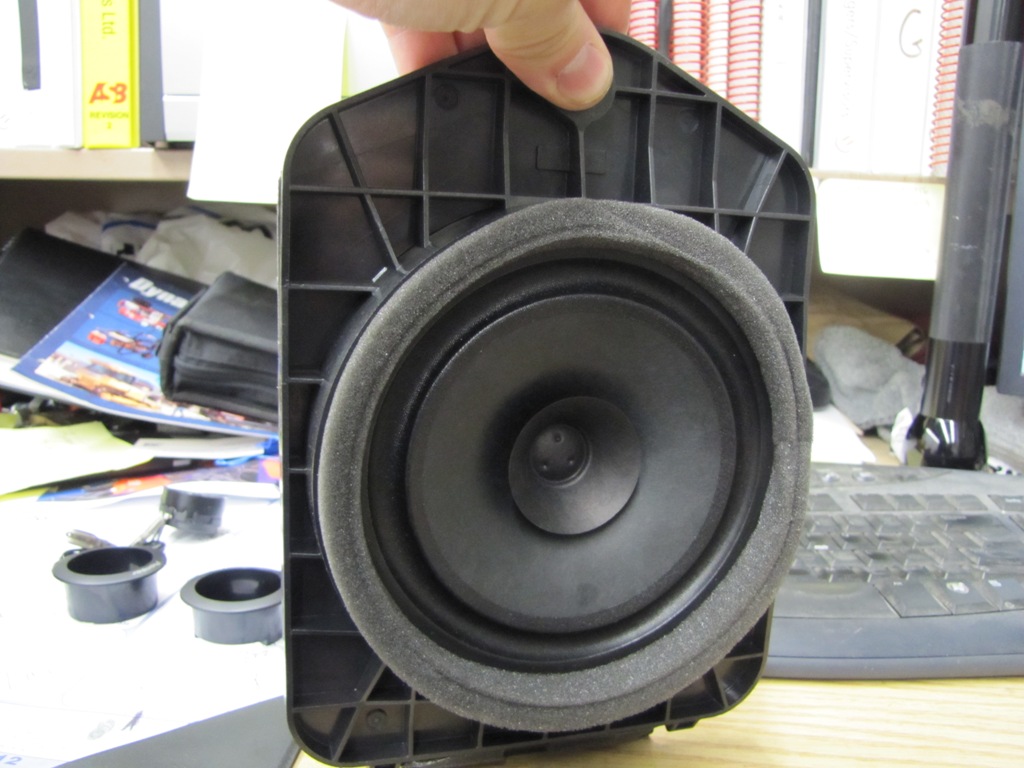

Here are pictures of the factory rear speakers in the extended cab.
They measure appx. 6 5/15 X 9
I replaced these first, and the sound improved alot. All that muddy sounding bullshit was gone.
Cheers, Brendan

i found the problem with these, they're made in Mexico, not China :lol:
thanks for the pics. now i have a better plan of attack! i think i'll do what you did with the aluminum plate, except use a 5-1/4" speaker so it'll fit in that round hole without trimming so much.
is there any trick to removing the stock rear speakers? the thing at the top on the back of the adapter looks hard to get the speaker out.
One 10mm bolt, then pull towards you until it unclips from the door, then pull up to unlatch the bottom of the speaker from the door. Almost identical to how the fronts are held in.
