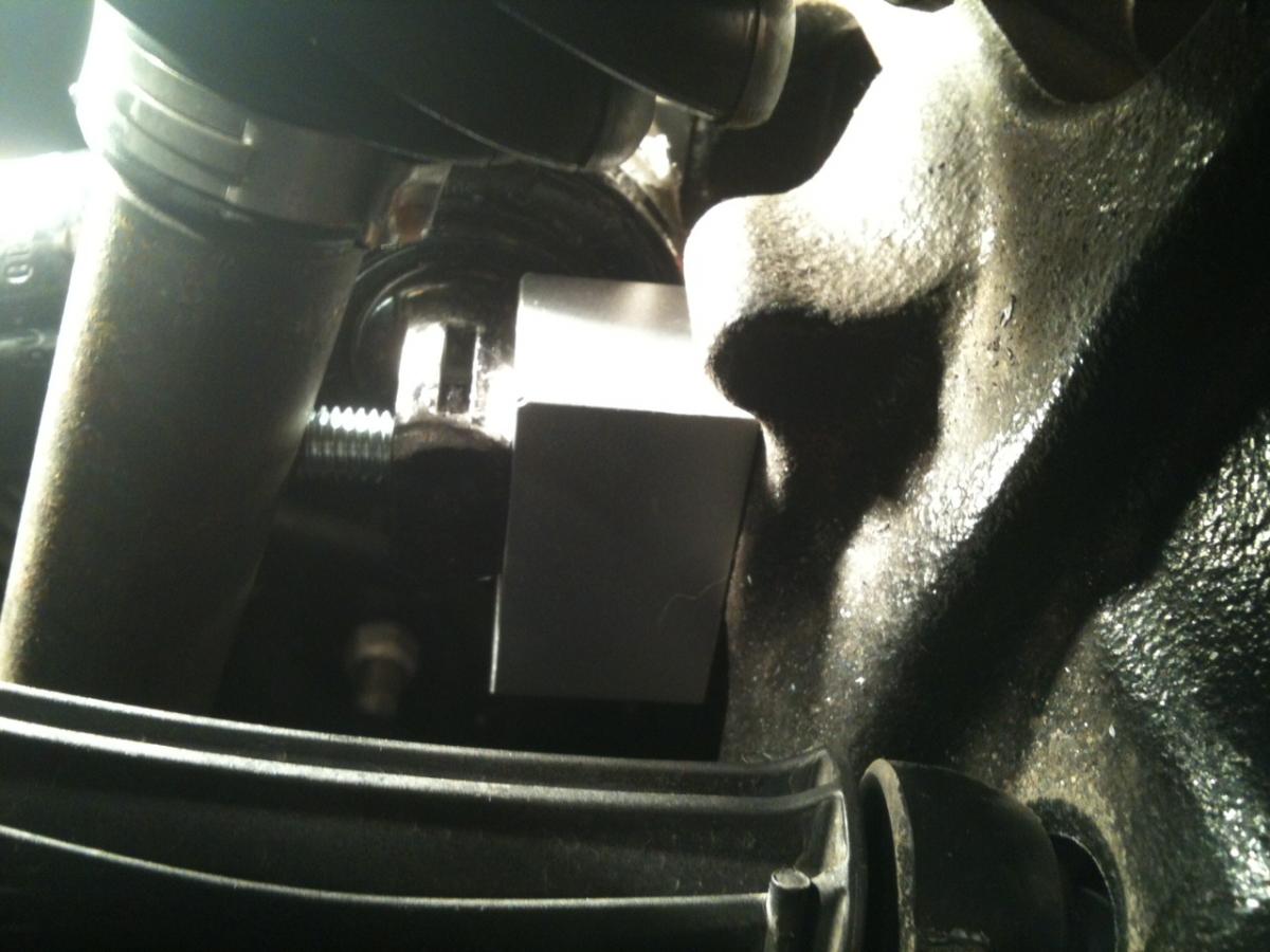

I took some pics with my iPhone, can't figure out how to post em. I can only put the bolt in from underneath, the cv joint is less than 3/8" from the spacer. Bolt hole is right in line with it
here you can see the bolt hits the cv joint--almost-- i can't even start to thread the locknut. maybe i should use a regular nut w/locktite?post-45327-0-20320800-1321459710_thumb.jpg
slid the nut in before you run the threads all the way up like shown in the photo. Just stick an open end wrench on the bolt and tighten from the bottom :thumbs: When the trucks on the ground, it will have more clearance.
i cant even get the nut to sit flat over the bolt hole...it gets stuck between the cv joint and spacer/shock mount
