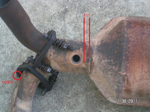

So I need a new catalytic converter. I can get a universal one for ~$80 but I don't see any way to fit it on the pipes because the front is right where the 2 pipes from the manifold come together. The all-in-one unit is ~$270.
Does anyone know of a kit I could buy so I can use a universal converter next time, e.g. manifold pipes, universal converter, and tail piece (3 pieces) plus clamps or flanges, etc? So next time I would be able to just replace the converter?
Or maybe use the pipes I have and weld on some flanges and use a bolt up converter? Any ideas?

@92rado: It's a thought. I have a stick welder but I'm not very good with it. I'm concerned about burning through the pipes. Anybody have clues about what amperage and rods to use?
It is extremely hard to weld exhaust with a stick welder. I would just pay to have it done so that way if you have any leaks they will fix it. But it's always cheaper to buy your own muffler or cat , rather than buy it from the exhaust shop.
Also when my cat went bad it started to smell like sulfer when it got hot.
@wavery: That's what I would really like to do but there is only 1/2" between the O2 sesnor fitting and the front weld on the converter. I guess I could cut it a couple of inchs back from there and try to grind the weld off hoping there is more pipe inside the converter.
Wrestled with a broken stud most of the day but finally got it out without taking the manifold off. There's a bracket between the alternator, power steering pump, and the manifold that had to come off before I could pull the manifold which, because of the way things are mounted, would have required me to pull more belt driven accessories off before I could get the bracket off. I did, however, manage to get the broken stud out.
Not sure where I'm going with the catalytic converter. Tomorrow....
