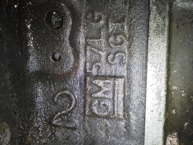

JirehCustoms Posted December 20, 2011 Posted December 20, 2011 This is the only numbers that I can find on this motor in my shop. I have not found and stamped numbers at all. Does anyone know what this is? It came out of a 2500 utility truck.
gmtech4 Posted December 20, 2011 Posted December 20, 2011 again i say" May " it could be a 350 sb or a 400 ... do you have a VIN ??? your pics are useless to me anyways
wierdo124 Posted December 20, 2011 Posted December 20, 2011 GMT400s didn't come with 400s ever. If it's a '91 or '92 3/4 ton it has to be a 350 or a 454 or a diesel.
C/K Man Posted December 20, 2011 Posted December 20, 2011 It's probably a 14093638 casting block, which would most likely mean it's a Gen. 1 TBI truck 5.7L, could be most any year 1988-1995. It should have a 1 piece rear main seal, roller lifters, and 4 bolt mains.
