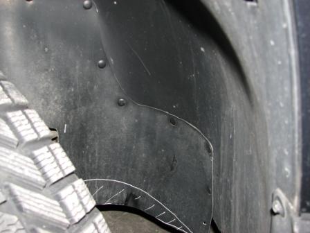

i built splash guards form corragated plastic to fit between the wheel wells and front bumpers. this seems to help with the spray in the engine compartment and also protects the window washer resivoir/pump and the fog light electrial connections.

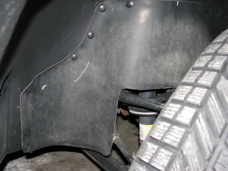

I made up front wheel well liners and for 2 winters now I have had no salt spray or rain get up in the engine bay.

Did you use plastic rivets to attach yours? The older vehicles used staples.
Yes I noticed road spray coming in from that omission also. I was a little shocked to see there were no supension flaps like in the older vehicles. Another thing to have to add to a $40K vehicle that should be there from the start.
I used the push in barbs to hold them up and the rubber is 3/32" pond liner rubber which seems to be standing up well in the different temps.

Same problem here, did a road trip to New York during a snow storm and lets just say that halfway there when I stopped to fill up the washer fluid I discovered the bay covered with snow. Then again the other day cleaned the bay out and drove during a snow storm and dirty again. Sucks. 2010LTZ4X4 I really like your wheel well idea and might give it a try.
