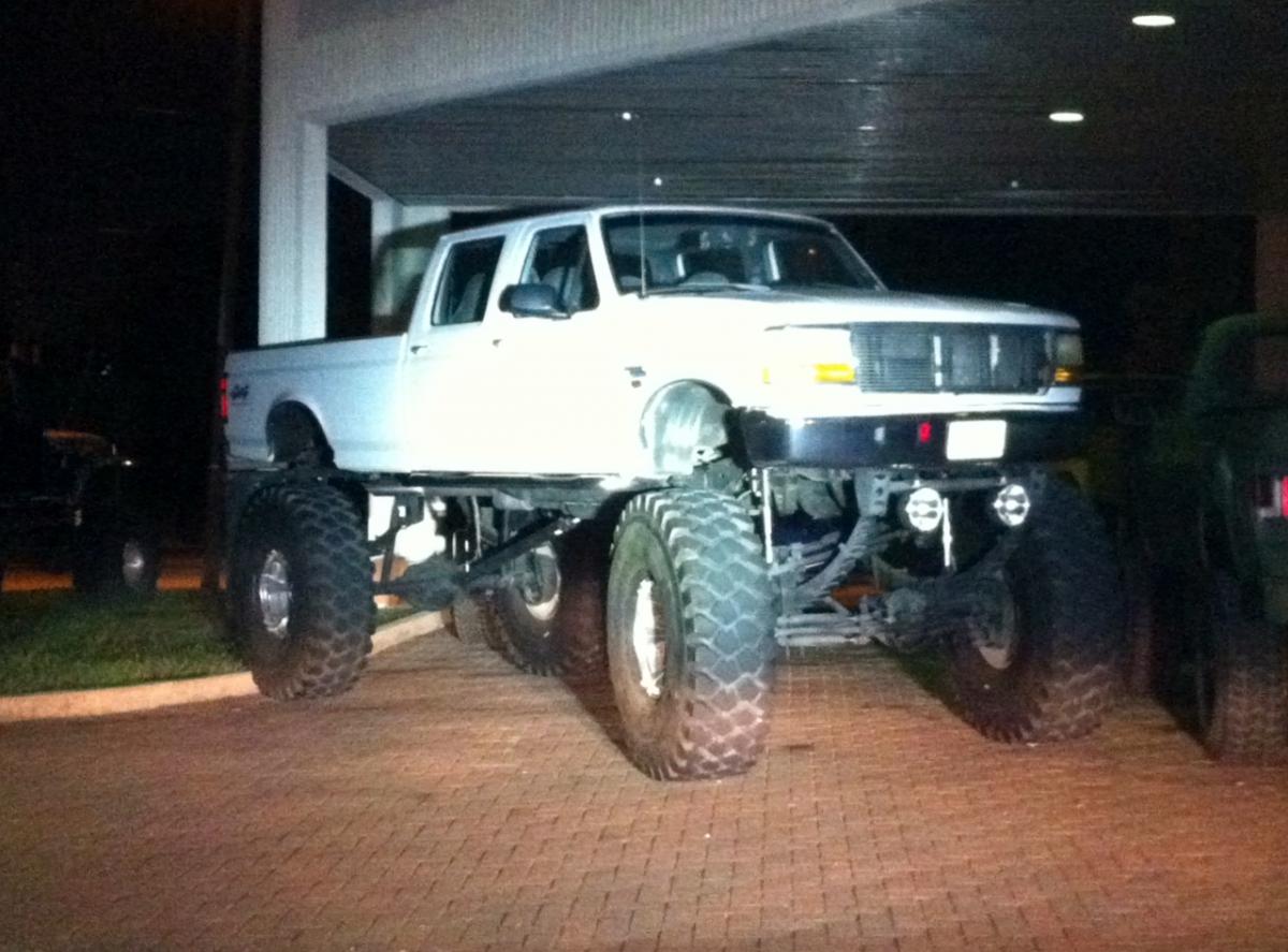

Here is your monster truck....... :)
Straight from the backwoods of NC......
That's what I'm talking about. But I think I am gonna stop at 35s. Not my dream but sould still be pretty sweet.
