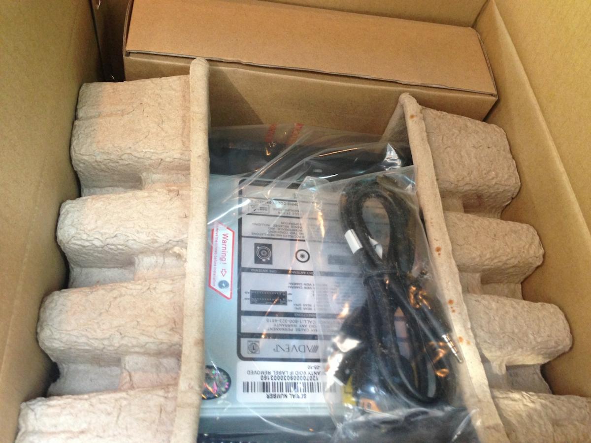

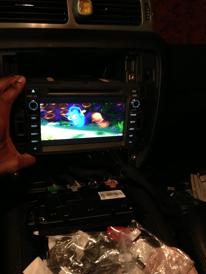

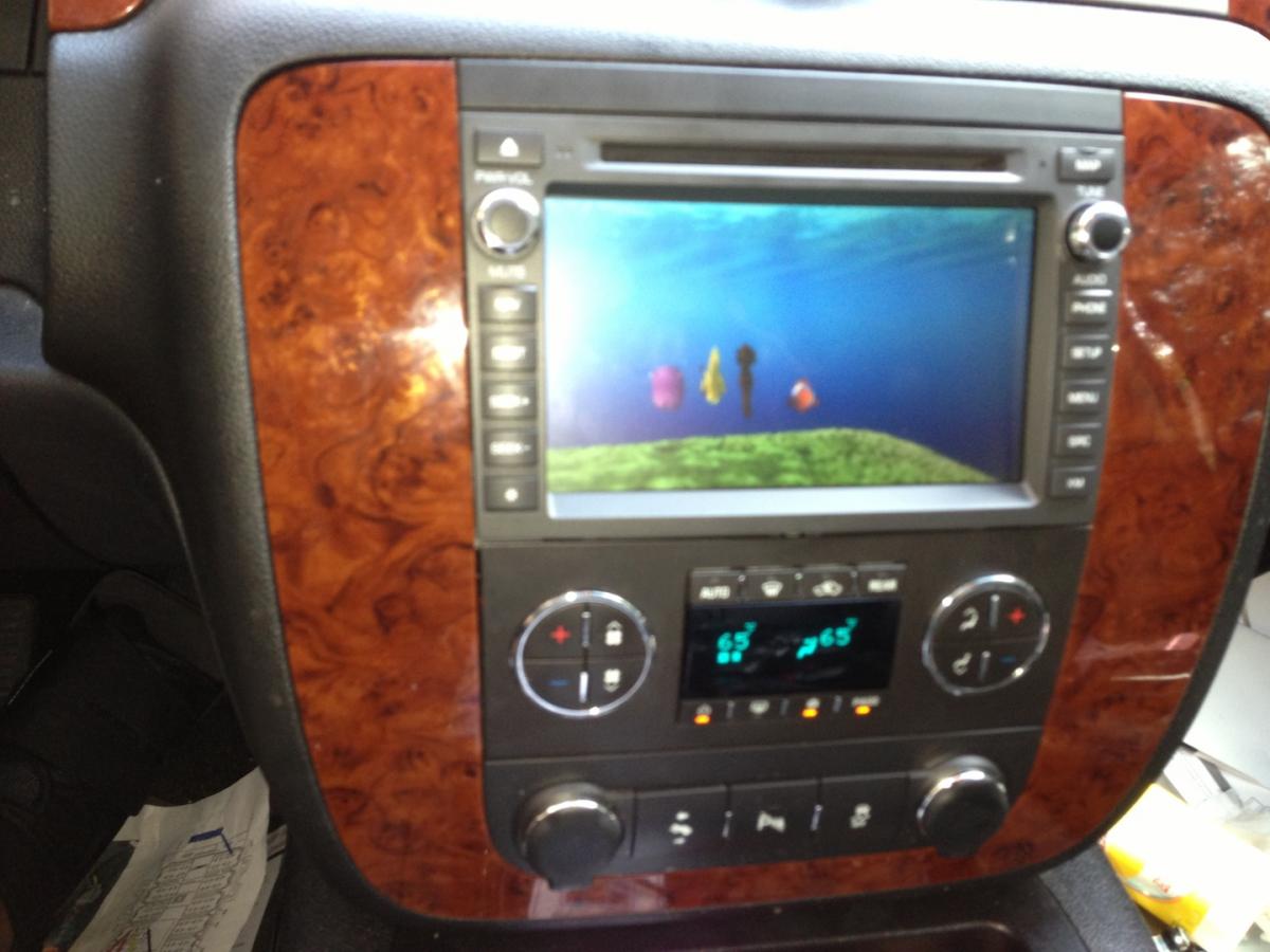

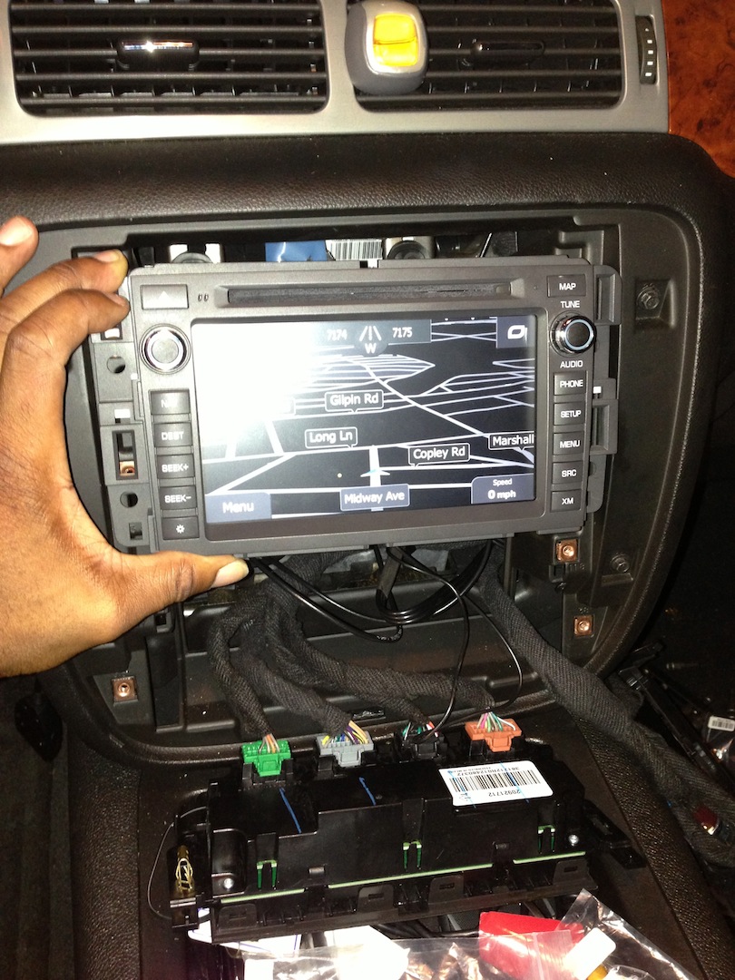

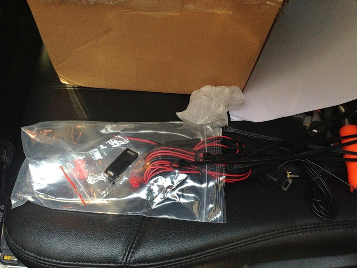

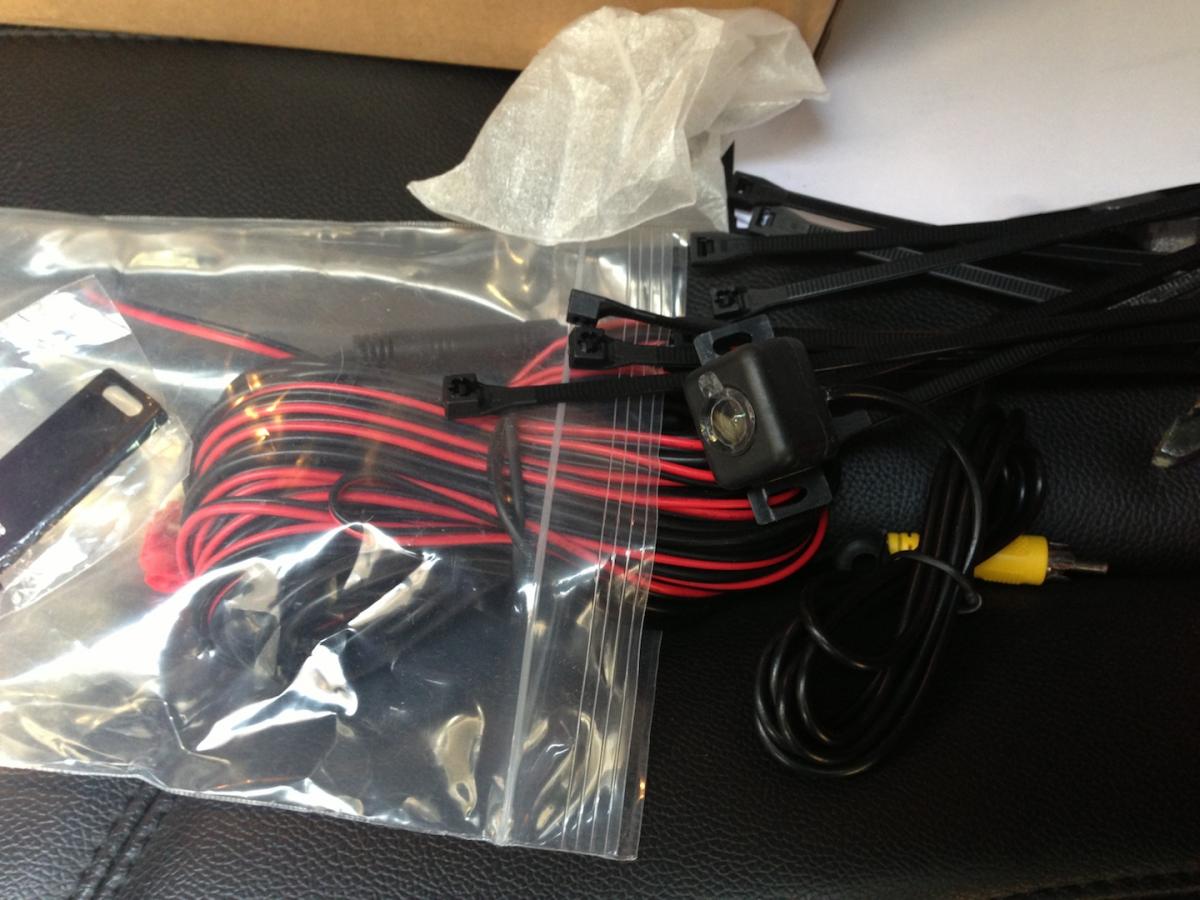

Installed my OGM1 today, well I started last night... The head unit, mic, and GPS adapter were a breeze to install. However installing the camera was a PITA! It was tedious work. Running the wires, drilling and snapping panels was no joke! If I had no experience with this I'd have ran to local shop to have it done. But I needy bragging rights.
Its crazy though, everything was really plug and play, no adapters or crazy extra steps to keep this looking stock. The rear camera though isn't for the faint of heart. Be prepared to do some real work.
Special thanks to Walt for his customer service and level of detailed information to make this a project I wasn't nervous to take on. I really appreciate your effort!
Check out the picks (taken from my iPhone 5 lol)post-116412-0-33761800-1348695844_thumb.jpgpost-116412-0-18375300-1348695850_thumb.jpgpost-116412-0-48397400-1348695855_thumb.jpgpost-116412-0-83612000-1348695864_thumb.jpgpost-116412-0-41689200-1348695871_thumb.jpgpost-116412-0-25849100-1348695881_thumb.jpg

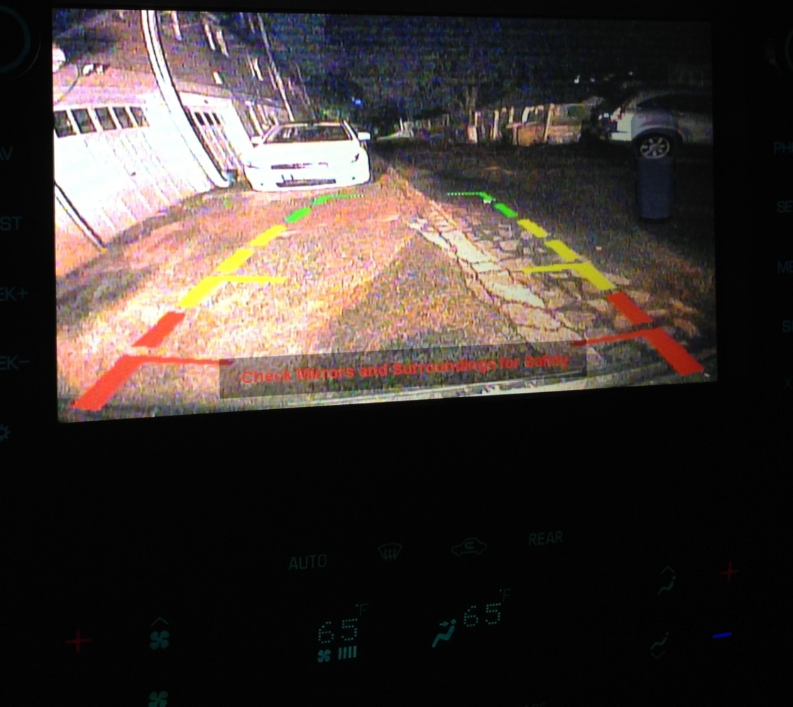

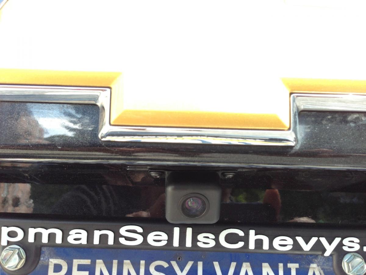

It is the CS-ulm1 universal lip mount camera, from ADC Mobile. They sell it 9 bucks cheaper than competition. It is mounted on the tailgate right above the License Plate (The screws go upright..) This is where the OEM LTZ Tahoe Camera sits... Almost looks like factory...
Just took this one in the rain hope you can see the camera. Adcmobile sells them for 160. It is mounted under the emblem under the lip. Hence lip mount camera. I took a night shot too in total darkness with my backup light being the only illumination and it was brighter than what my naked eyes could see. Walt said it has night vision. I'm really impressed with the camera.

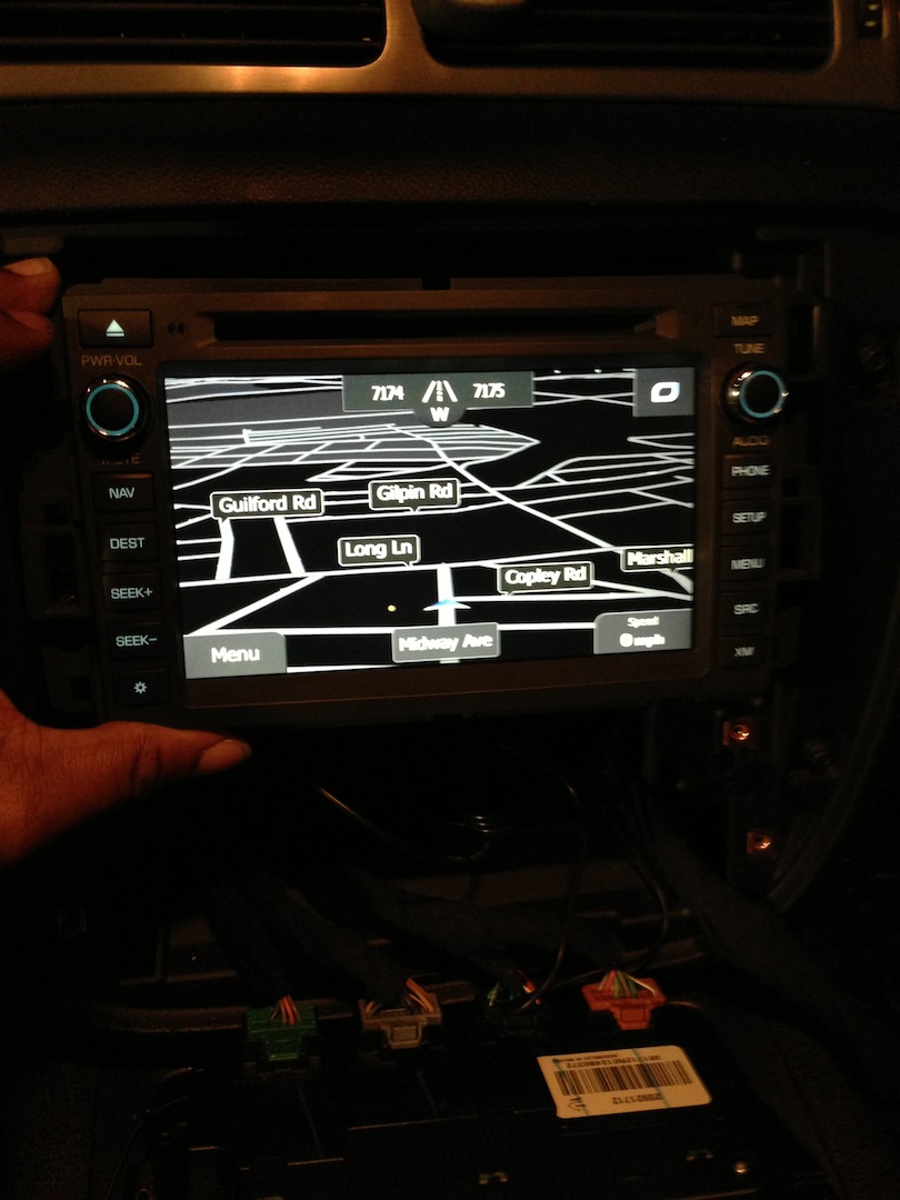

what navigation is the radio running. I have the OGM1 as well, but mine looks much different.
That's the same iGo Nav only it's running in night mode...

The problem I refer to with the backup camera. I find that it washes out pretty bad in bright sunlight. Look at post #2 above at picture #5(IMG_0299.JPG) I actually had someone walk by the rear about 25 feet away and I could not make out their skin color. They showed as a white human shaped blob. Mine also seems to be out of focus. Not sharp. At night, the picture is usable but very grainy(alot of static). All this aside, it does work and gives me capabilities I did not have before. This is the camera from camera-source. Maybe I just got the older CCD version instead of the "Super CMOS" version.

can you take a another picture of the mounted camera. Ive been looking for something like this. How much was the camera?
That mount wouldn't work well on a pickup, it'd sit too low I think. You'd be best off getting the OE-style one in the tailgate handle.
..... The problem I refer to with the backup camera. I find that it washes out pretty bad in bright sunlight. Look at post #2 above at picture #5(IMG_0299.JPG) .....
Oh Actually the image was fine... That was flash from my iPhone 5, I am pretty happy with the image quality.
