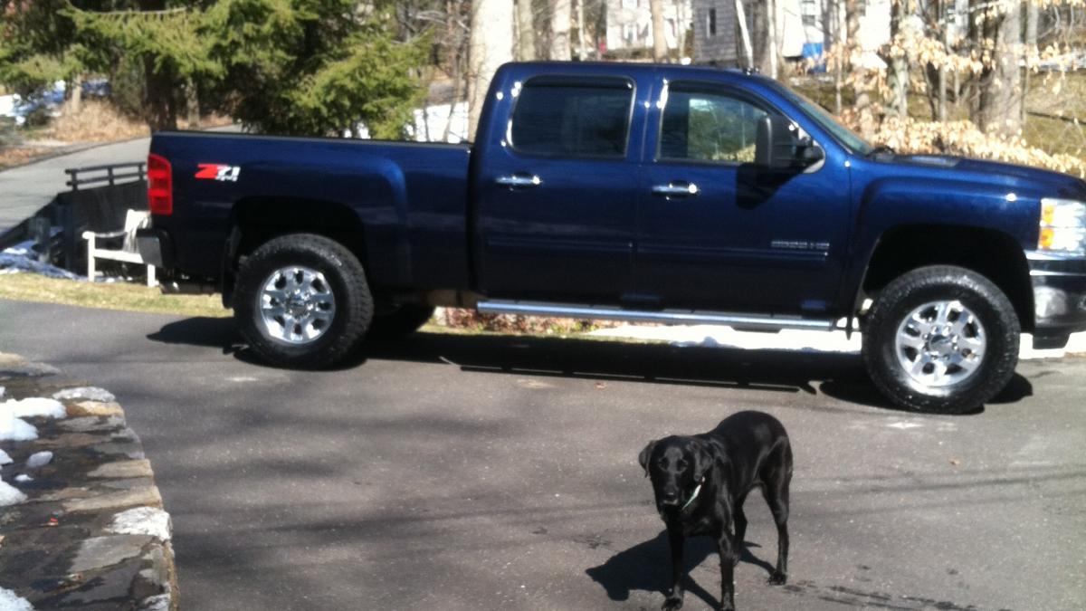

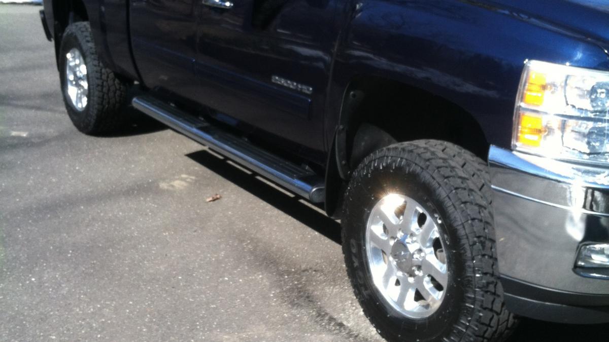

285/70/18E TOYO A/T 2
seasled
Put new tires on, great snow traction,these tires are 35x11.50 with just keys on my 2011 2500 great so far!
That looks really good. I have pretty much the same truck but am waiting for the original tires to wear out before upsizing tires. What wheels are those? They don't look like my factory rims. Any rubbing noticed?
factory 18"s, and it rubs the mud flap ever so slighty, at full lock in reverse on a hill, this is just not enough to worry about.
You've done exactly what I have been thinking about doing and I think it looks great. I like the wheels on this truck, just not the way it looks with the factory tires. You mention that the pics are of 35x11.50. Are they 285/70/18's? My calcs show the 285 as measuring 33.71". Don't get me wrong, I think it looks great, I just want to understand what you have. I have already leveled it, so I am now shooting for the look you have achieved. Thank you!
the tires are 285/70/18E ,toyos website specs 34.8 x11.3,and the sticker that was on the tire said "extreme series" 35 X 11.50 . hope this helps, this is why i posted ,because i had been looking for info to see if anyone with my set-up had done this and found no results.

if you have the leveling keys these should work,off the toyo website,open country AT II
p/n rim hgt wdh
LT285/75R17 121/118S E/10 352790 7.5-8.0-9.5 63.1 17 33.9 11.3 15.1 3195 2910 80 80 N/A 614 3P+2S+2N 3P
Are those an Xtreme model or the regular AT2? Any chance you could post a closer up shot of the sidewall if its the non-Xtreme? Apparently the side tread on the Xtreme's is taller.
That does help, thank you. After I posted, I looked on some of the tire sites and they listed it is a 35x11.50. I am not sure why the tire calculators don't agree. Thanks again and nice job!
it is the extreme.
