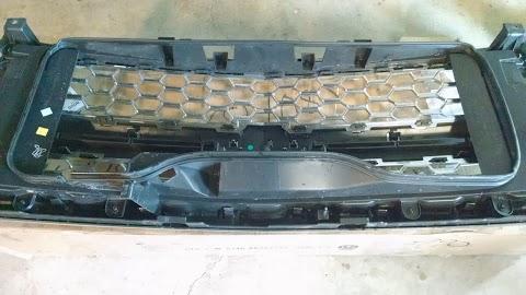

If you don't mind the hassle, remove the tail gate and lay it flat.
Take out the front emblem and lay that flat too.
I had to be very careful of runs on the rear emblem but the front one I removed and that ensured no runs.
Just remember, LIGHT LIGHT LIGHT coats for the emblems.
You'll have to remove the grill. [Why not dip the whole grill now?? :thumbs: ]
Check out this thread for a How-To:
http://www.gm-trucks.com/forums/topic/156014-2014-silverado-grille-removal-how-to/?hl=grill&do=findComment&comment=1384980
At this point, you can remove the bowtie by carefully releasing the tabs holding the emblem in place.
