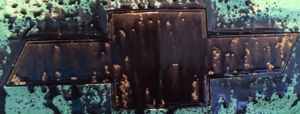

Just sprayed the first coat.. It comes out in an uneven spray every time... It's not even coats, it's like balls of plasti dip... It hits the emblem and runs because it sprays such big blotches !!! Is this normal??
How much did you shake it? How close to the bow tie were you spraying?

Did you do the super light coat first? It supposed to be a like a dusting first let dry the a good coat next.
I went light.. Or at least what I thought was light? I mean it just comes out like balls of plastic lol... Once it sits for a minute it turns more like a liquid and runs
Is it the brand? I have performix plasti dip.. I shook the heck out of it.. Went light.. Just did my second coat. Seemed to "take" a little better.. We'll see once this dries
What temp you spraying at?
It's about 45 degrees here
I've watch those videos u have linked... I noticed there's sprays just like spray paint... My can sprays like silly string. Perfect example!! Idk why!?!?
when i did mine the other day i heated my garage up. It was at least 60 the whole time. I did 4 coats with 25-30 minute dry time between each. Mine turned out great I think.
