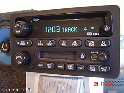

rick5295 Posted January 17, 2014 Posted January 17, 2014 i was looking into adding the steering wheel controls to my truck but wasnt sure if i could because my truck dont have some of the features on the steering wheel. my truck doesnt have onstar or xm or any of the bottom controls' features the radio i have is if i bought the wheel how would i go about hooking it up and what would happen with the bottom buttons
