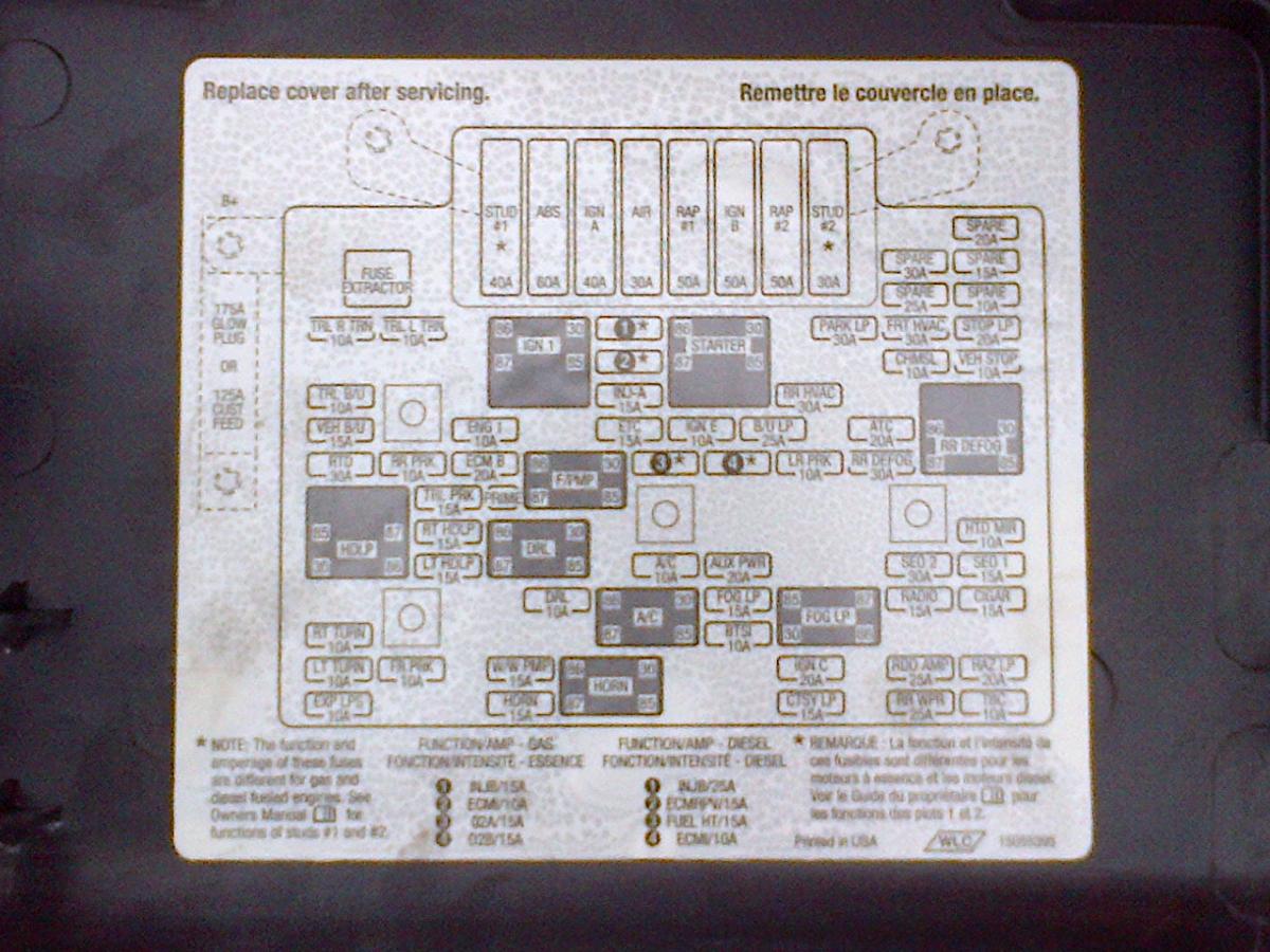

if there are 2 terminals in the fuse area then it needs a fuse ,,,,,if it has none then its just empty ,if just one then you can add a terminal at a great PITA
so if there is gold inside it means it should have a fuse? and where theres no gold inside the hole means I don't need none correct? this photo here is not from my truck I just want to confirm if that's what you mean? Thanks govtech4
yes the top cover that you pull off yes has a black and white diagram yes and it states amp number fuse to use but its not there in the spot so its missing? or is it supposed to be missing? or there should be one there?
ok govtech4 I got the real Actual Photos of my 2001 GMC Sierra 1500 2WD 4.8L Truck pics of the fuse box please tell me, if these ones that are missing is normal? or not? please tell me in detail I appreciate it. Other photo is in next post Thank-You
