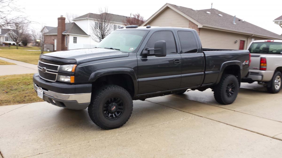

I included a picture of my LLY. Never before seen on GMT.com!
