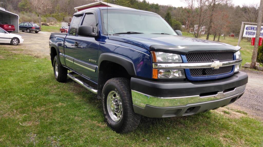

Stopped at a guys place today to look at a 2003 2500 6.0L with 206,000 miles on it. It drives really nice for all those miles, even drives better than my dads with less miles. Price is really good IMO at $6,000, but it has a couple problems that I was wondering if anyone on here knew what they could be?
First one has something to do with security. It doesn't happen often, but he told me that it will start up, show a lock symbol on the upper left dash, and the truck will shut back off. Sometimes it takes a few tries after this happens before it will start again. When I test drove it everything worked fine.
Second problem is that when you turn the right turn signal on the high beams come on. I'm guessing it needs a new switch???
When I looked under the hood it had some kind if module hooked up too. Not sure what it is, but I have a picture along with some others.

:ughdance: The infamous "performance chip"! known to increase power by 100hp and give 5 mpg. :bs: Basically my understanding is it lies to the computer. This one appears to be hooked in with POS crimp clips to the MAF, probably to trick the ECM into thinking it needs more fuel. Gotta give them an F for wiring know how.
It doesn't look like a bad truck, I would talk them down more though. I wouldn't pay $6k since apparently it was owned by an idiot.

On Google I'm getting either a bad BCM, Passlock sensor inside the ignition switch, or bad wiring.

These trucks are so temperamental with wiring that the module and its associated wiring my be triggering a lot of those issues. Anything electrical is always scary to me because with a closed loop system it could seriously be anything. If you do buy it I would start with pulling that module, cleaning up the connections, and hooking it back up stock. That module may be totally fried considering it is zip tied to a coolant hose as well.

EDIT: Side note, does the front end feel tight? It may be the photo but the front tires look like they are cupped pretty good. May never have rotated either which would do that too.
Yup front end felt pretty good to me. As for that module if I bought it that thing would go in the garbage can, but I'm with you the electrical problems scare me. I don't like to pay someone an arm and a leg to fix stuff if I can do it.

That looks like a really nice truck to me. 206K is a lot of miles but 6.0L's can run 300K easy. The truck looks well taken care of from the pics. Maybe ask if you can take it to get inspected by a reputable shop? Then ask the shop about the turn signal lever and the pass lock issue.
Lmc has a replacement lever at a good price. Check em out they will send you a free catalog. I stay away from trucks with those "100+ HP" chips.
