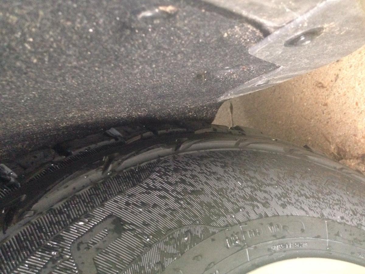

As title says I'm looking for the biggest tire that will fit on my truck without rubbing or requiring any kind of a lift. Truck has 18" wheels, and I'm looking at a set of 275/70/18's. Anyone know if this will fit the bill?

Correction..... Went back and gave new tires a once over. On my Factory 2014 Chevy Silverado 1500 LTZ Z71 Crew cab with 275/70/18's do have min rubbing. I will for sure be putting a 2" leveling kit on the truck now.
Dang, I know others have ran that size without a level...and claimed no rubbing. Every brand of tire is slightly different though. If you don't want to do the level, it looks like a couple holes and a zip tie would fix that rubbing issue pretty fast.
Going by memory and sight, the Cooper ATPs appear to have bigger tread "lugs" than past sets of KO's. Honestly I think it just the tire. Picture(which I can't understand why it's sideways) doesn't do justice. It is just barely touching with wheel turned all the way. Friend of mine knows a guy who will install a 2" leveling kit for $200 parts included out the door. Plus alignment I'll be out $250ish and rubbing issue will be solved, truck will look better in my opinon and I'll have a little more ground clearance up front. :-)
Sounds like a good plan. They look better leveled anyway. :thumbs:
