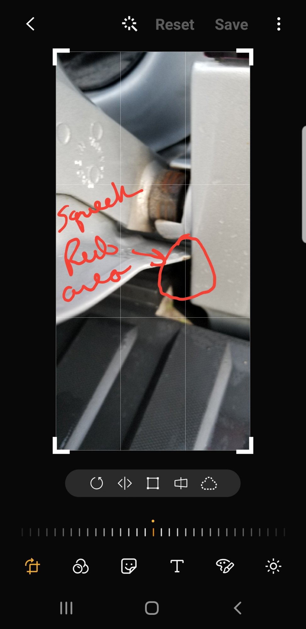

When I bought my truck the tailgate was squeaking. The salesman looked and concluded that it was just a hinge that needed some grease. the other day when I was closing my tailgate I noticed though that this is not the case. The tailgate is squealing because its GRINDING ON MY TRUCK BED!
See the pics. I could try to take it off and align it, but it's so close on the other side..
Is my truck out of spec or something??
The other side doesn't have a lot of room either.

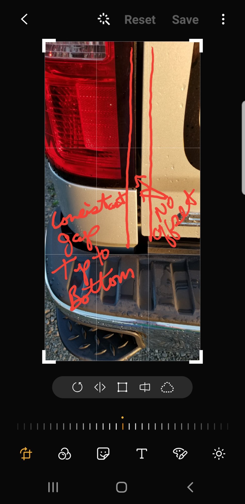

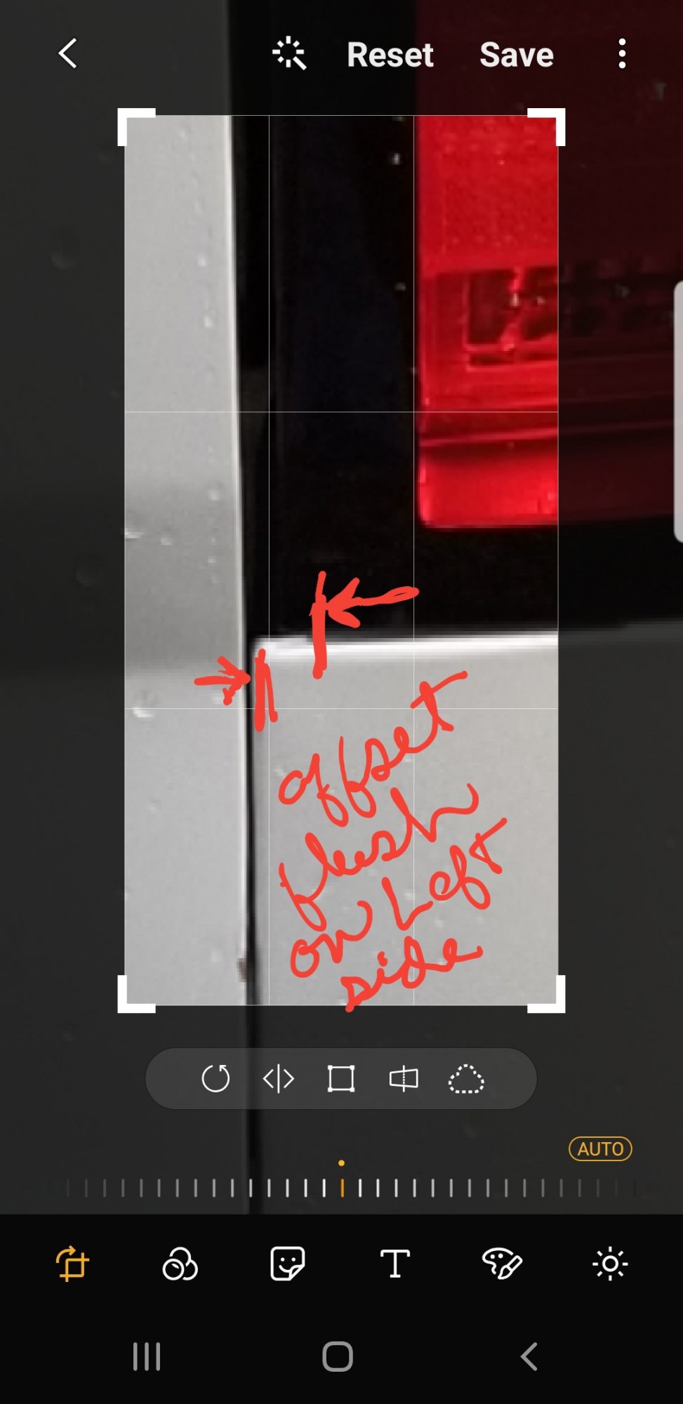

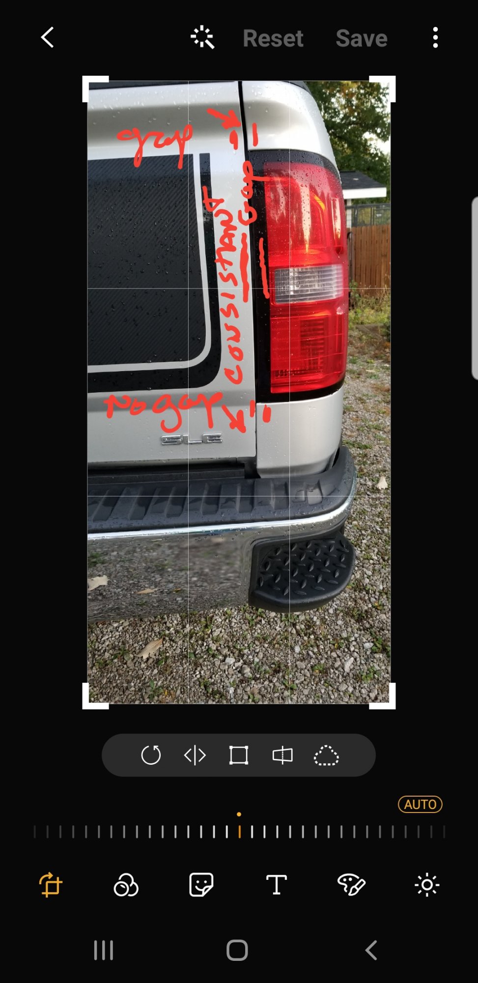

I have the same problem.  2014 lease return. clean carfax. I think the left quarter panels are miss aligned in the weldment. Mine didn't start until the paint rubbed through. I see zero adjustment to slide the tailgate to the left. Very visible in the pictures I marked up and attached.
