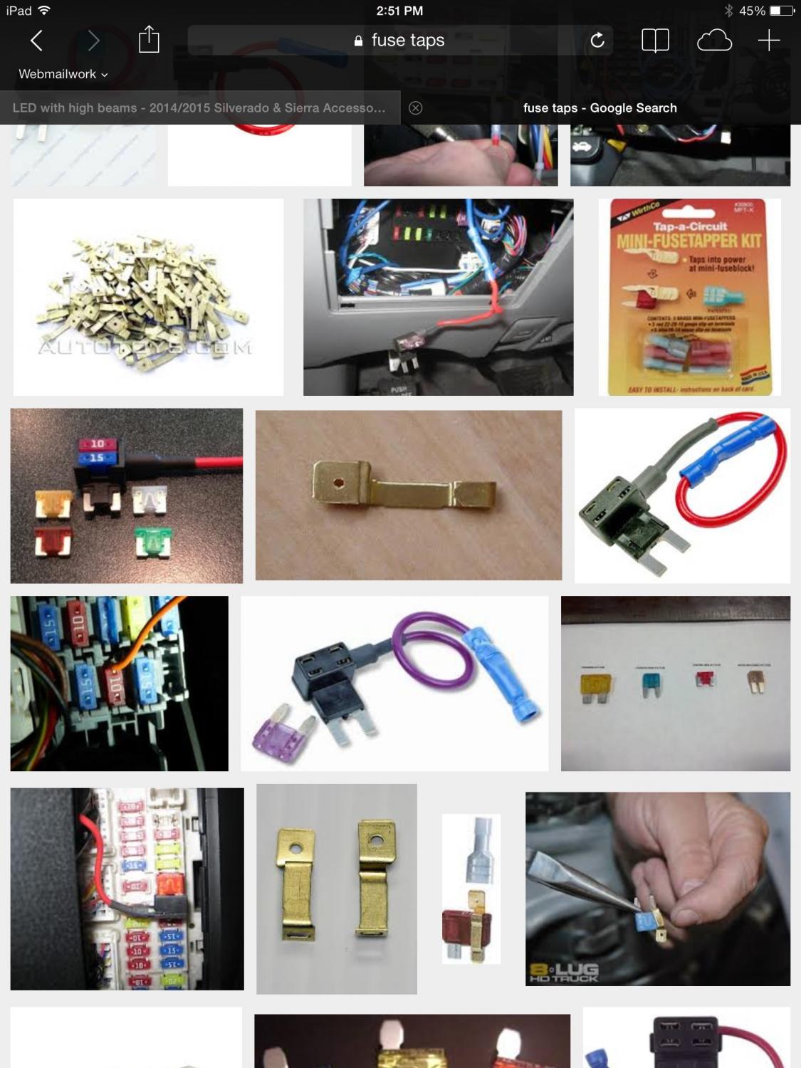

what kind of fuse tap did you use?
Grote but different suppliers carry them they are slotted just slip over the fuse tab I'll try to get a pic of one
So that worked on the 3 pin micro fuse? I can't find a store that carries them locally. Would has to order them inland I wasn't sure if it would work.
These are some options micro fuses usually are a slip on type because of the terminal size
So it's going to take a while to get this in. I'm going to break down and tap into the high beam wire. Does anyone know which wire on the non LED headlights (SLE)?
