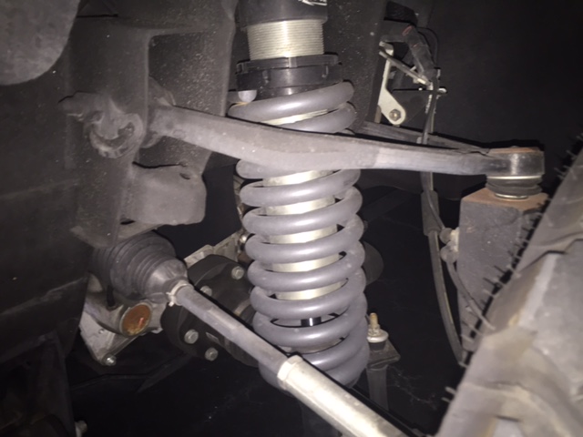

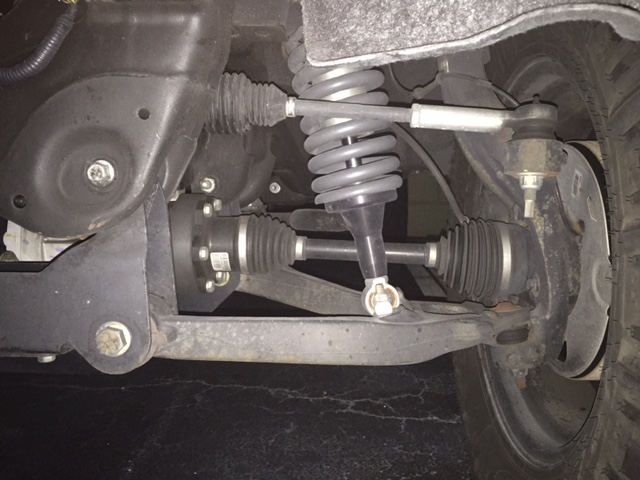

Angles are good, right now, snapped a couple of pics. I would get a set of Uniball CA's also.

Life, your angles are perfect. You shouldn't have any issues stretching it to 8". The new UCAs will be icing on the cake.

The '14s have the same suspension at the 900s and the amount of suspensions I've seen both in person, and on these forums, that are "stretched" is more the rule than the exception. I myself have a 1" leveling kit in with my suspension and the alignment is fine.
Look at it this way as with Life's truck. His lifted angles are flat. They're basically stock angles. So it's not different than adding a leveling kit to a. Stock truck. It will basically create the same geometry up front.
As to fitting 37s. I know the 14s have more room than my gen, but I currently have 10" of lift with 37x12.50 on 10" wides with -24 offset, I've only trimmed plastic but they can still rub pretty good in tight turns, mainly when backing up. So I don't know that 8" alone will allow 37s.
