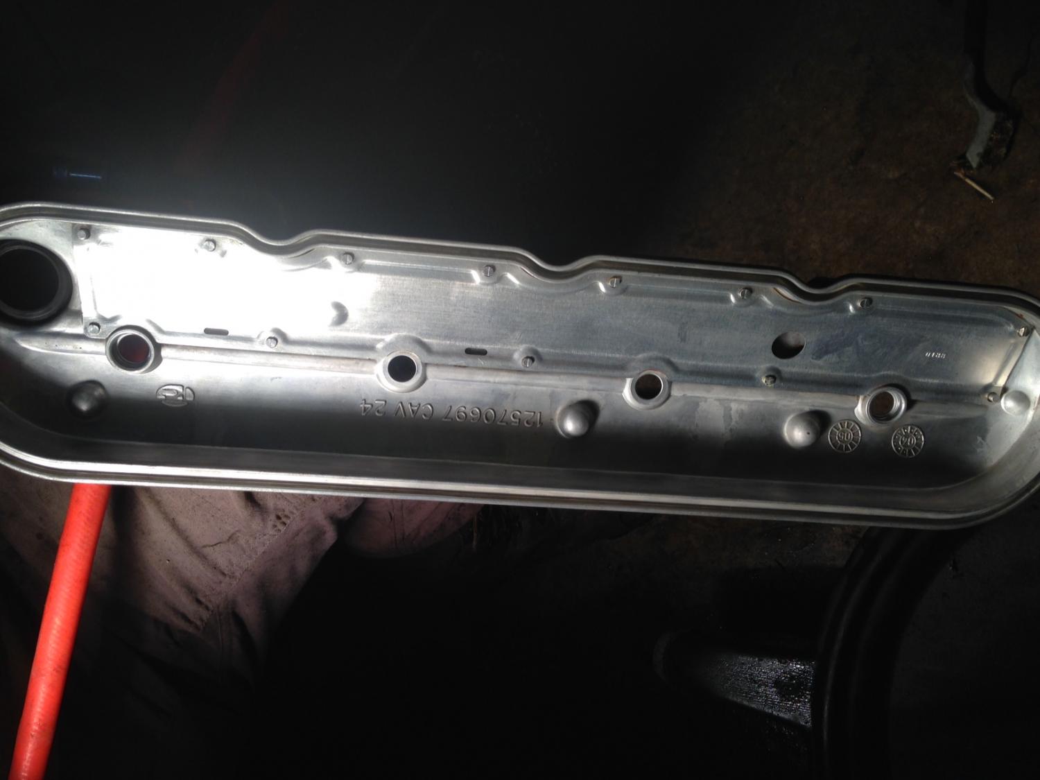

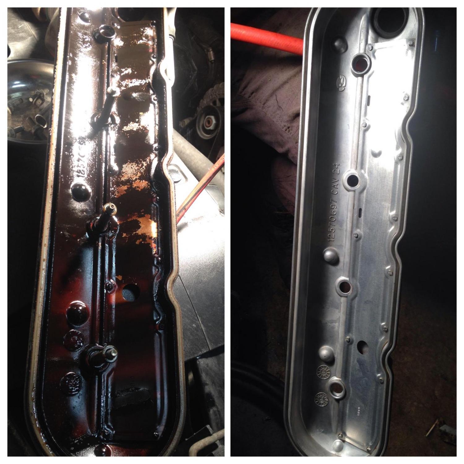

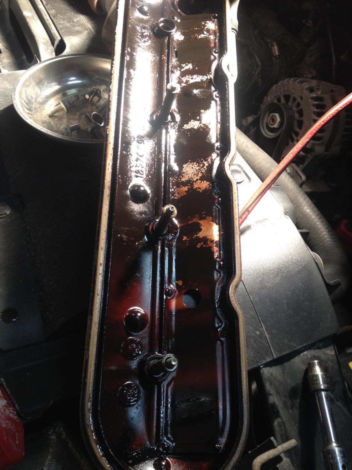

Fast fwd to the recent -10* days and I noticed it smoked on startup. Truck was down 2.5 qt. Poked around on the forum and found some threads about the clogged fixed PCV orifice in valve covers. Figured with 160K miles it was time for a peek under them. As you can see from the pictures they were due.
BEFORE
AFTER
COMPARISON
Could they have been so blocked that some oil backed up into the intake and that it what truck was burning? I have a long drive coming up this weekend with the truck and will see how she behaves. If it continues to smoke what would my next course of action be valve guide seals? Any thoughts would be helpful.

So after cleaning the valve covers, changing the oil truck went on a 600 mile trip over the weekend. I am happy to report that so far so the smoking issue is gone. I looked for it each morning when started and after sitting for a few hours.
3 adults, 200# of junk in bed, cruise at 65 into a head wind hand calculated mpg of 16.73.
