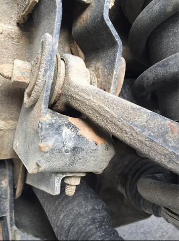

do these RC control arms provide more clearance over the droop stops. i have the 7 inch rough country lift and any quick drop to the suspension causes the control arms to bring up solid on the drops. my shop was going to trim the droop stops or would it be a better option going with theses control arms?
Yes these arms are welded higher up on the bushing bracket so that they don't hit the droop stops at full droop.
You have two options, either keep the stock UCA's you have(which appear to be steel) and cut the droop stops out with a grinder or else get after market UCA's that allow more down travel and have better ball joint angles which should increase ride quality.
so even with a complete 7" lift the control arms sit that close? they must take the 5" kit and extend the strut spacer to 7" and call it a day. Id say go with the control arms, that way you are correcting your ball joint angle and saving some wear and tear.
also, are you missing your camber pin? mine worked its way out when i was tightening the control arms. had to tack weld it back in because it wouldnt stay. Just wondering if your camber is off and maybe causing the control arm to be lower than it should be?
