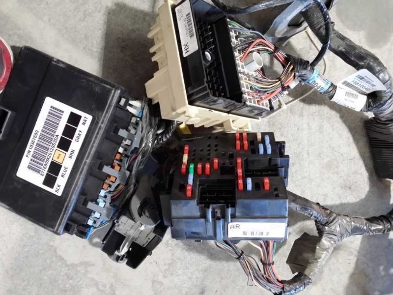

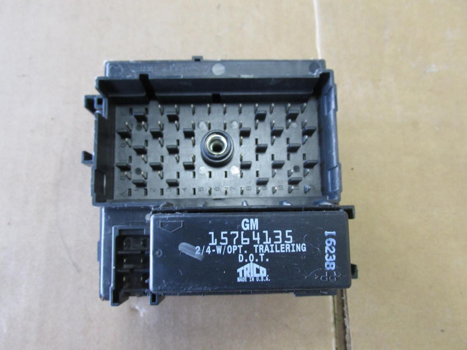

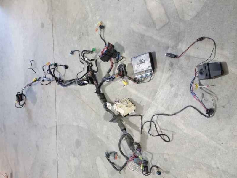

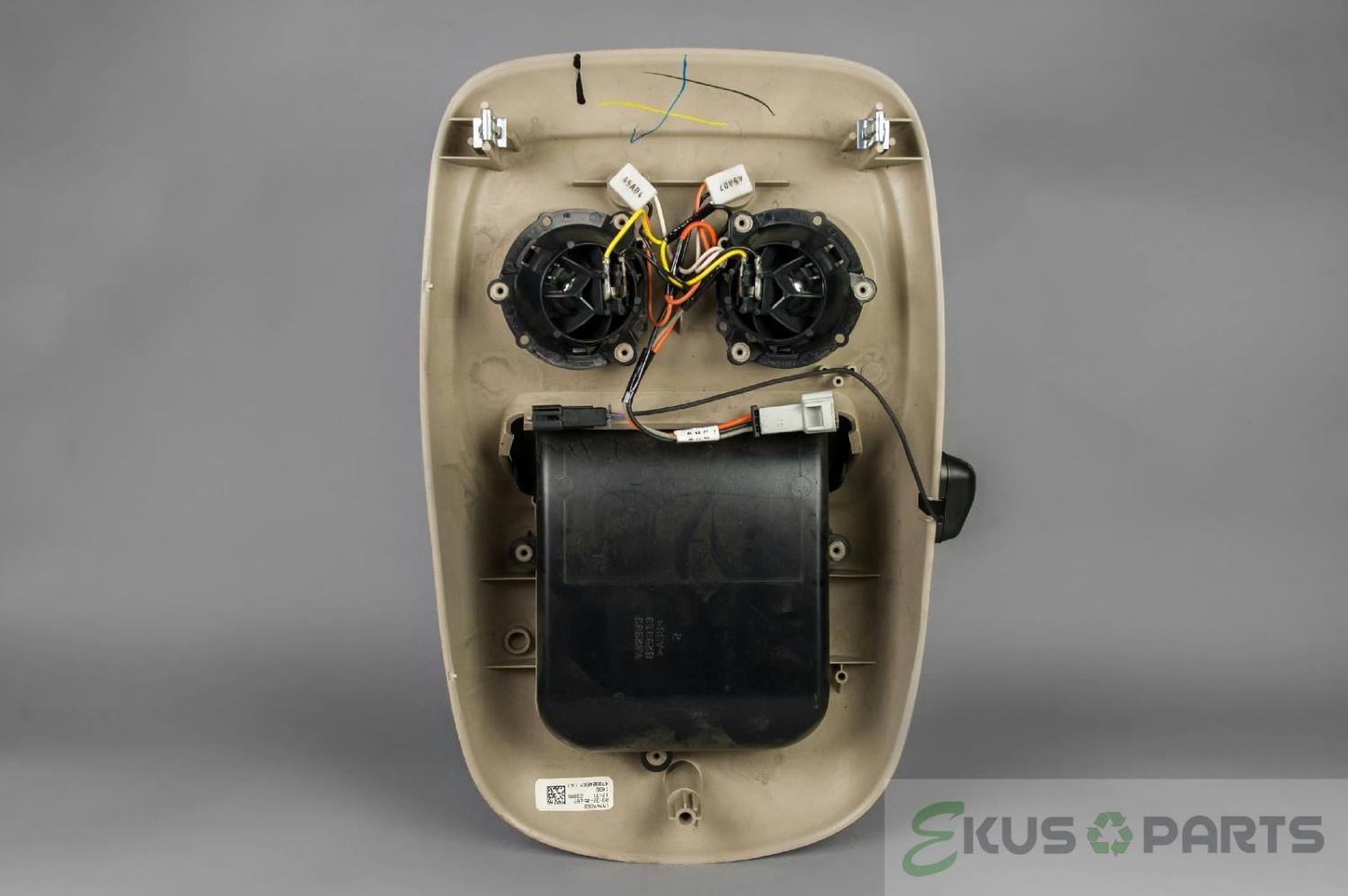

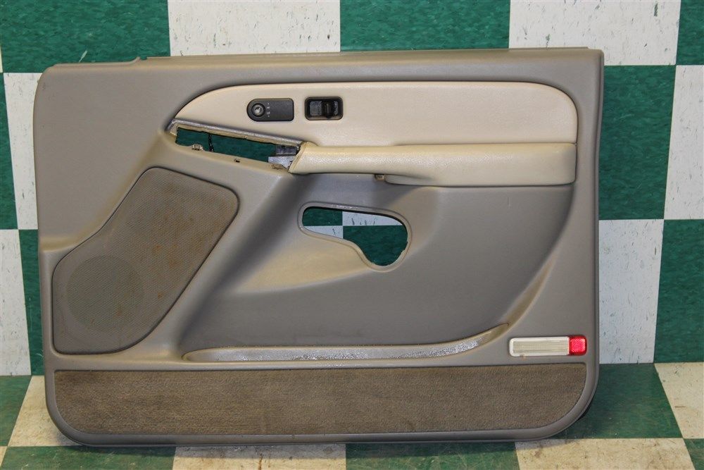

I know I probably bugged this forum to death concerning a retrofitting project for a WT truck to have 1LT features such as power windows, locks, mirrors, and overhead console. I have gathered pictures from ebay to make sure if these are the parts that I need. If there is anything I'm missing in the pictures, please let me know. No dime has been spent on the parts just yet.
Well I can't comment on whether or not you have everything. I just have to say once you get all the parts you are going to be one busy individual. Take your time when you're doing install. It'll be worth it when you're done.
The overhead console does NOT look like the one in my 2011, BUT you failed to say what year you are working on. Profile says Toyota.
its an 07 Classic WT extended cab. It has the custom cloth seats already equipped which are normally found on the LS and 1LT models.

The only thing i can see is the inside door panel is for a 00-02 body style truck. '03 and up have different seat heat buttons. Panel should fit but wouldn't be year consistent.

Well that panel picture is just for reference only, but yes I will use an 03+ for sure.

Me neither but I will probably do it on a whole day off. The project will commence in January 2016. but first i will buy the parts. And one more question: if I buy a BCM from a 1LT truck plus along with all the wiring and fuse blocks, 9/10 it should fire up right?

Im about 75% sure. Best thing will be to get a complete interior with wriring and BCM. They made a 1LT reg cab thru crew. So you can find the config you need

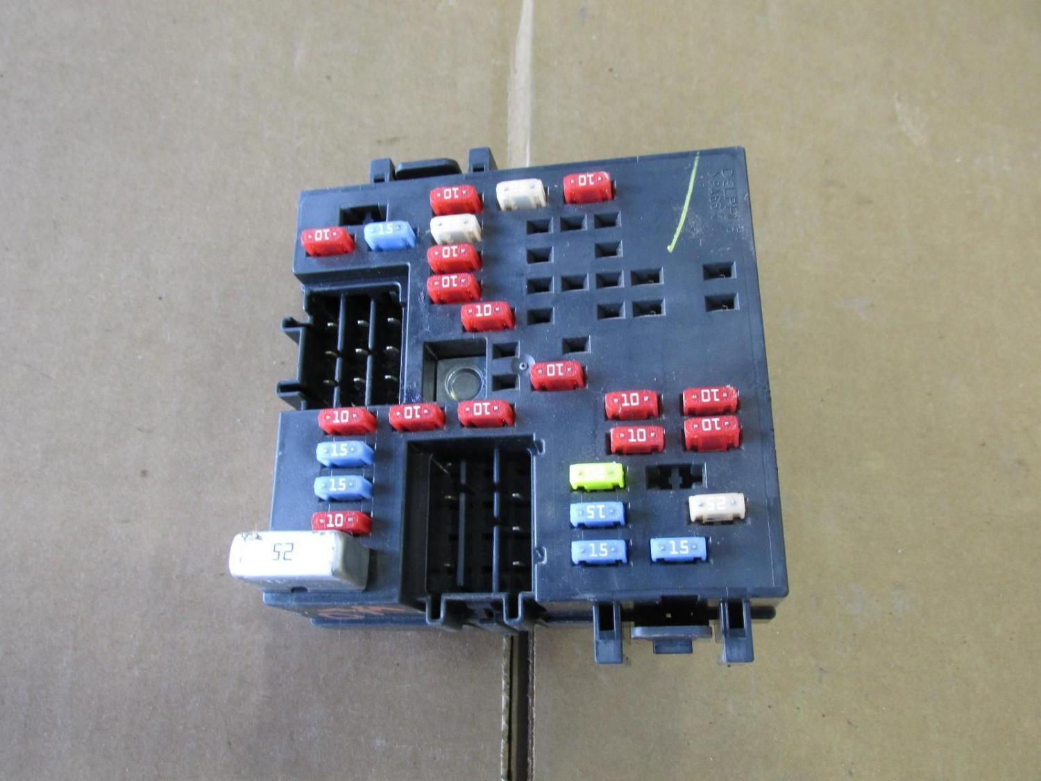

That's exactly what I will be getting. One last question: again, not trying to be redundant, where does that entire "white box" fuse panel grounds to? In other words, does it ground somewhere in the truck or does it just provide its own power?
