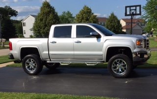

The rear is dead on 1 inch higher than the rear which Im ok with. I would just prefer the CV angles to be flatter. The BDS 6inch kit is their 4Inch lift with longer struts so you end up with CV angles the same as if you did a leveling kit. the down travel is also minimal I attached pics of how close the control arm is to the stop. In the next couple weeks I am going to take of the coil overs and adjust to lower the from 1.5 inches so I will have 4.5 inches of lift in front. DS said this is height will still give me enough clearance for my tires and the truck will ride even better since it will have more control arm drop.

I had mine lowered 1.5” which is what Bds recommends to still run 35” tires without rubbing I don’t remember the fender measurements. First pic was at 6” lift second pic is lowered to 4.5” lift. If you do lower the front make sure you switch out the sway bar drop bracket to the one used for 4 in lift kit
