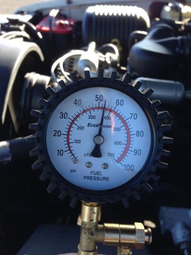

I checked my fuel pressure and its 59-60 key on engine off and 52 at idle, jumps to 60-62 after blipping throttle.

Pressures with current pump...
Key on Engine Off
Idle
I will post new pics after installing new Delphi HP10001 Fuel Pump.

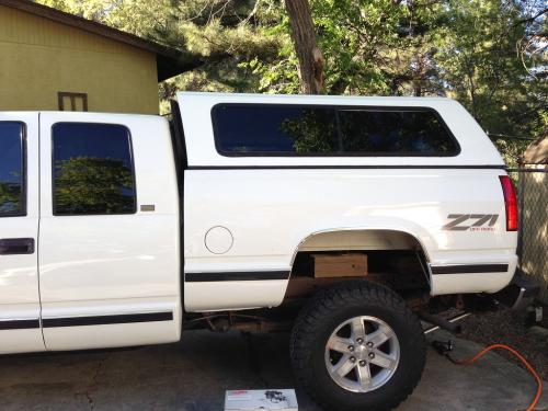

I will post some pics of my bed with topper jacked up. Only complaint is it was crampt getting lock ring back on. I guess I could have raised the bed a bit more but I thought I was pushing things at the angle I was already at.
Edited by 2009 GMC

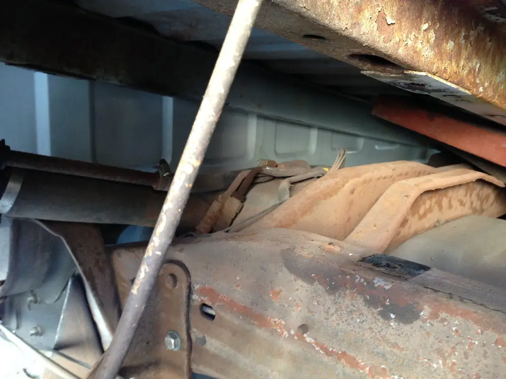

Pulled 3 driver side bed bolts. Loosened 3 passenger bed bolts about half way.
A little tight but removal of old pump and insertion of new pump was easy. Getting the lock ring off and back on was the hardest part.
