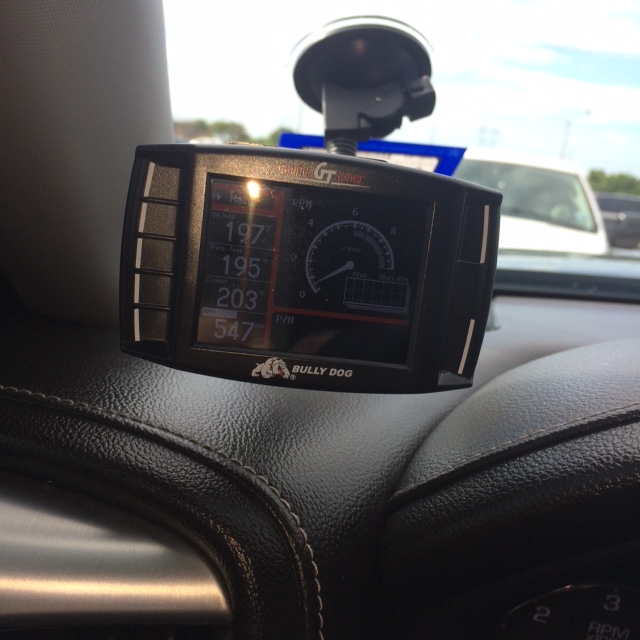

I have a BullyDog, and to tell you the truth, i cant even tell that i have it
