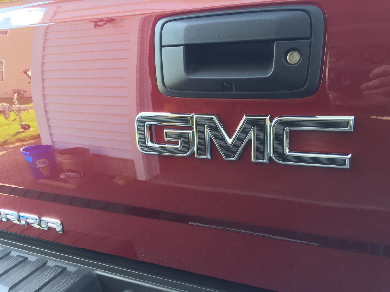

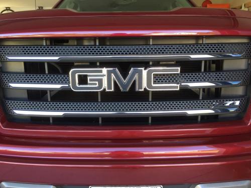

I put 4 coats of plastic-dip followed by 2 coats of Glosifier on both my front and rear emblems. I also added the Z71 logo to the bottom left of my front grill (got the idea from another member). I'm still debating on debadging the emblem on the tailgate.

Yes, there is a natural break between the chrome and red on the emblem. The trick is to take it slow, don't try to rush it. Also, I would tape off and cover more area around the logo than the guy in the video does, it just saves you the hassle of having to remove overspray. The front emblem took a little longer to prep than the rear one also.
