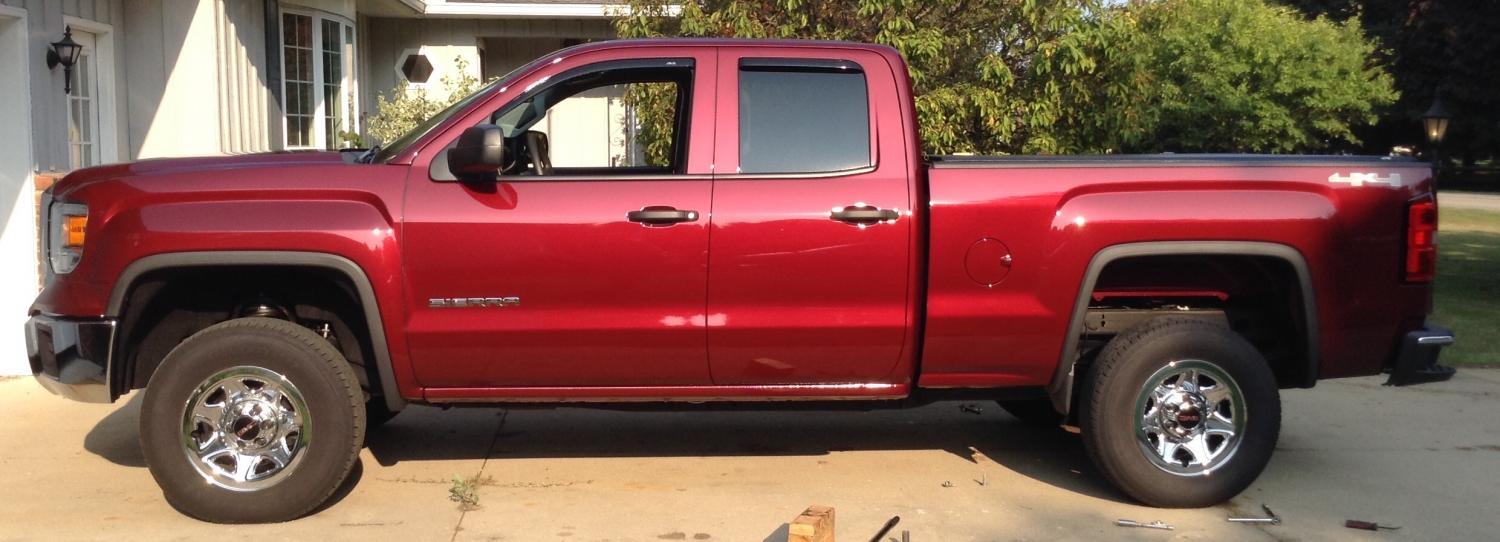

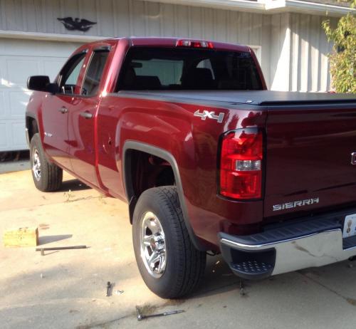

Bought a base model Sierra in June and so far have added a TruXedo Lo-Pro QT tonneau cover, AVS vent visors, RC 2.5" leveling kit and removed the front air dam from the bumper. Will be more to come, but still doing some research and trying to plan my direction.post-147573-0-40637600-1440629541_thumb.jpg

Airraid MIT with AEM Dryflow filter and Zone 1.5 body lift ordered.
Once the 1.5" body lift is installed, what is your plan for the stock wheels and tires? I think as your truck grows it will cause them to appear small.
Was thinking I'd like to try going with 285/75r17's. Seem's to be a given that you can run 33x12.5, so im thinking they would still fit even though they are taller given that they are narrower. If not I'll just run 285/70's. Probably stay stock on wheels not seen anything that is a got to have wheel yet.
It's just Michigan's Iraq Veteran plate with Iraq Campaign Medal. Was torn between which one to get, so I got that on my truck and the ZJ has the Marine Vet plate. Just ordered new tires, should be at the shop in 3-5 days.
Got a delivery this afternoon, and started the next project. Took a break to grab a drink and a couple progress pictures.

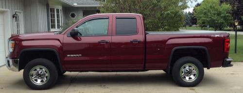

I finished the BL install, and got the Airraid MIT and AEM Dryflow filter installed. Front/rear fender height at 39 7/8 and 40 1/2. Now just to wait on new tires and come up with next project. Probably holdout for tune to correct speedometer and try to squeeze a little bit more to offset the added height and weight of tires.

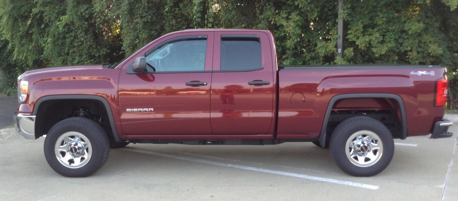

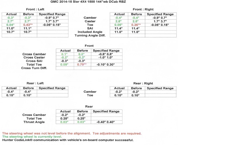

Did the RC install on the 22nd and finally able to get the alignment done today.

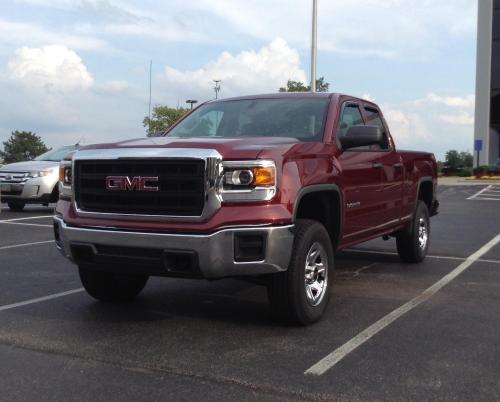

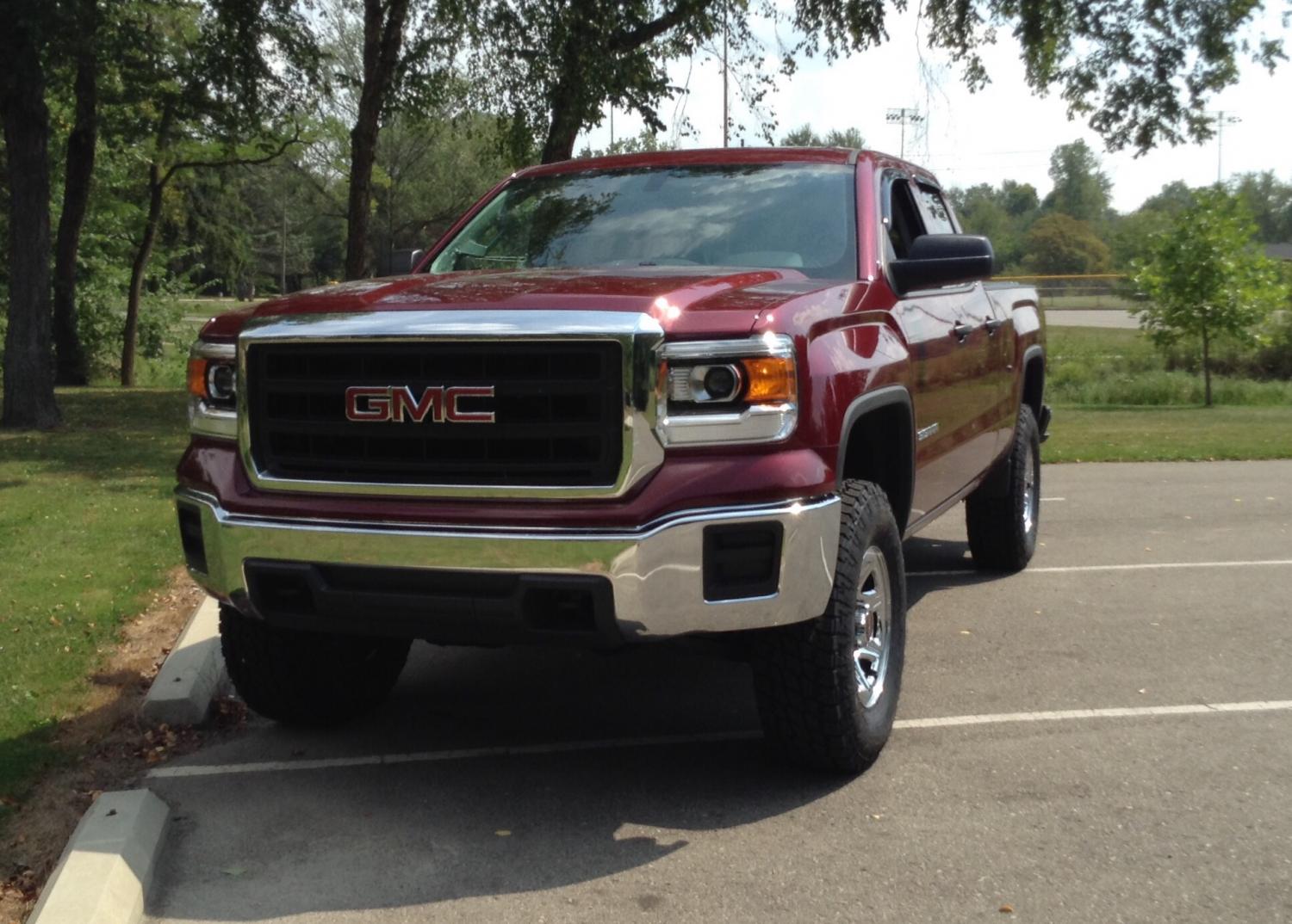

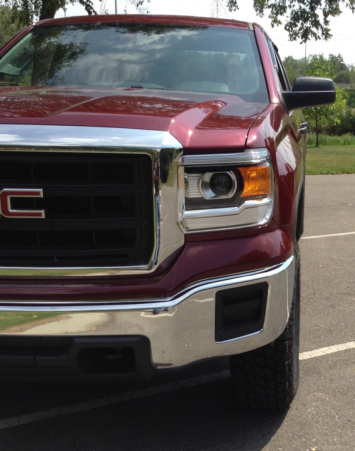

Got the new tires installed and stopped off and got a few quick pictures. Went with Nitto Terra Grapplers G2 in 285/75R17. Stopped in an empty lot did some full lock turns, only rub slightly at full left lock in reverse. Took a look and appears it is on left front at the rear of wheel well on the outside of tire. Had about an 1/8 gap when stopped so not sure if I'm going to bother with it since full lock reverse is rare for me. Wheel well to ground measurements are at 41 1/2 in the front and 42 in the rear.

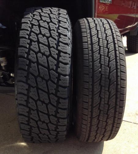

Just a pic comparing tire size. Mounted is Terra Grappler G2 285/75R17 next to stock General Grabber HTS 255/70R17.
