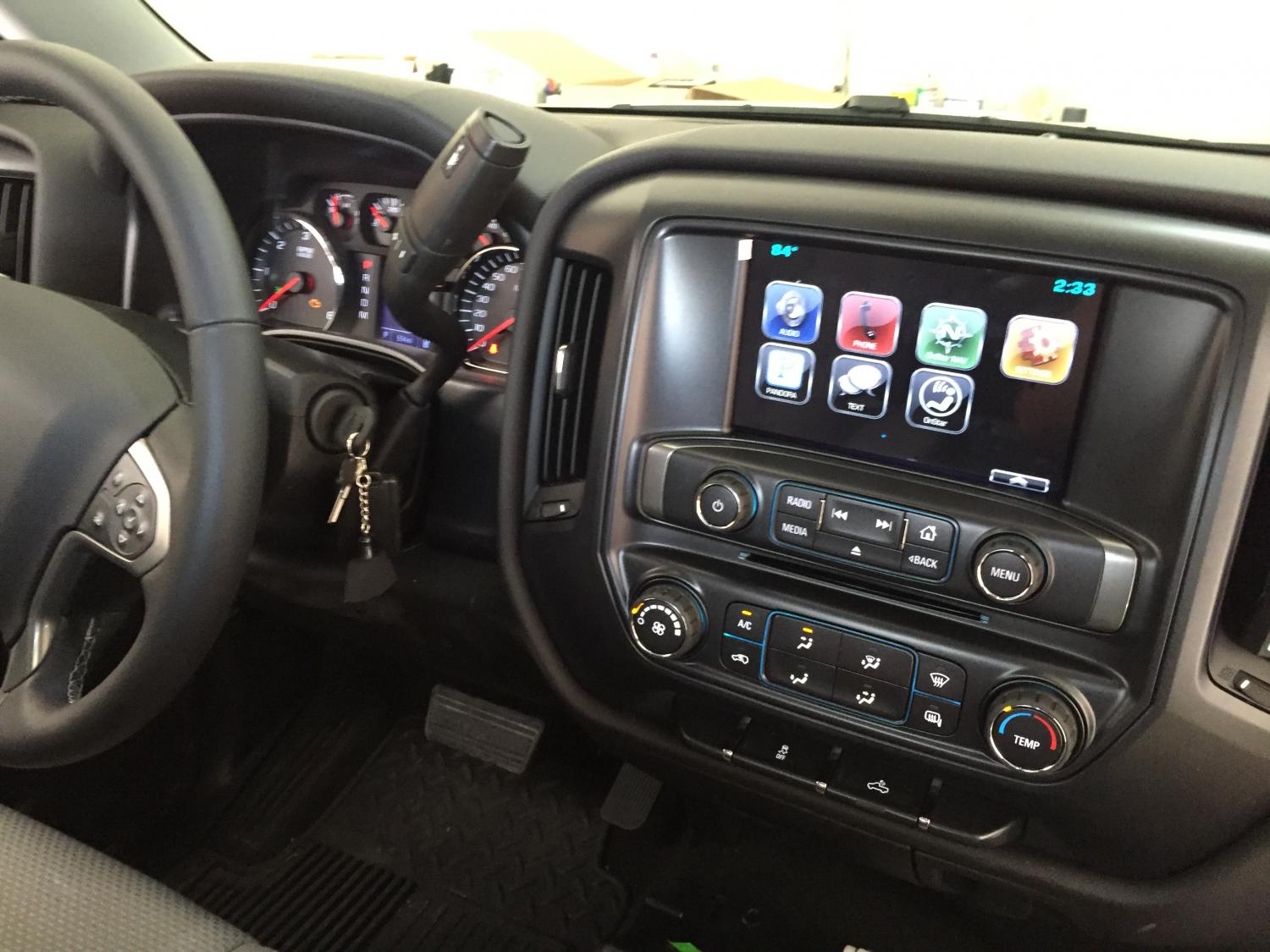

I did it on my Regular Cab, money well spent.
Vader, does it include Nav? Can you explain how you did it? From what I understand its merely swapping out the units+ dash and replacing that HMI module behind the glove box.
I did it to my truck what I did was get the screen from a wrecked truck and contacted mvi for a hmi they programmed one and sent it out and I did the swap in 45 minutes
I went with the IO5 unit that doesn't have the built in nav. I had the IO6 with built in nav in my 2014 LTZ and found that I still relied on google maps, more so now that you can choose to have google maps voice prompts play through the speakers.
I do miss the weather app for some reason, as silly as that may seem.
There is about a $200-300 price difference between the IO5 and IO6 when upgrading from the IO4, so if you want the factory nav get it up front or it will cost you like $600 later on which is about the price for the IO5 to IO6 upgrade.
You also need to make sure that the 4.3 that you are replacing is the IO4 unit and not the IO3, I think the IO3 can be replaced but it may be even more expensive. Replacing the IO4 just means swapping the screen and bezel and the HMI module.
As other have said, you can get the units second hand and have the HMI reprogrammed, there are a couple different avenues for getting that done.
