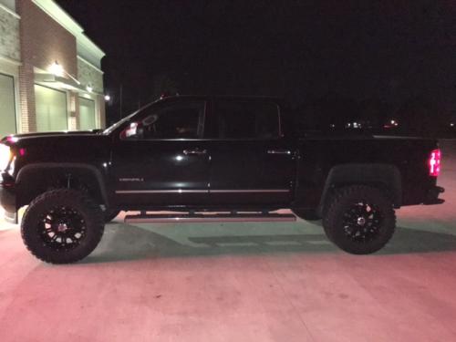

Had my 6" Fabtech lift installed on Friday. I love it! Drive is very close to factory. The only thing is that the 35's do rub sometime but I already knew there would be some minor trimming. Other than that, no complaints.
