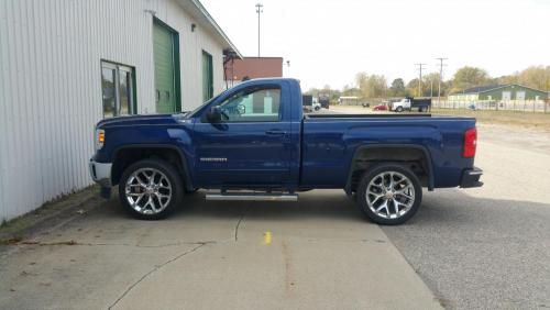

Added some mghauphy 2" rear drop shackles. Still sits 1" higher in the rear as the rcsb sit a little higher then the rest stock. Truck also has a 3" cat back exhaust made by me with a dynomax bullet muffler, and a AFE cai.post-150876-0-10959000-1448583522_thumb.jpg

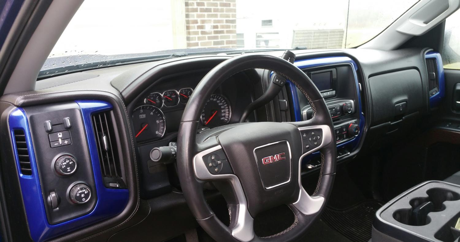

how hard was it to get these trim pieces off?
did you sand and paint, or have a shop do them? they look great, something I've been considering doing....

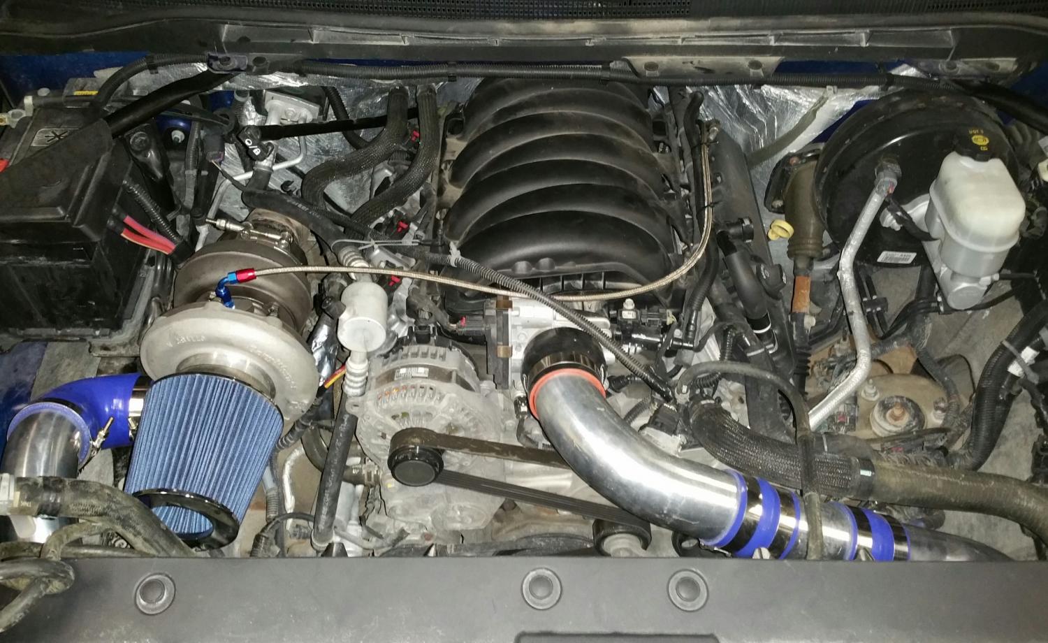

Thanks for the compliments guys! I'm currently working on a turbo kit for these trucks. Once I get everything ready to show I'm going to get in touch with the guys in charge of the site about marketing them on here so keep an eye out.
Thanks! They pop off really easy. I took a butter knife with a piece of electrical tape on the end to make it "soft" and started at a bottom corner. I painted them myself. First I sanded them then shot 3 coats of the testors laquer with 2 coats of the testors laquer clear.
