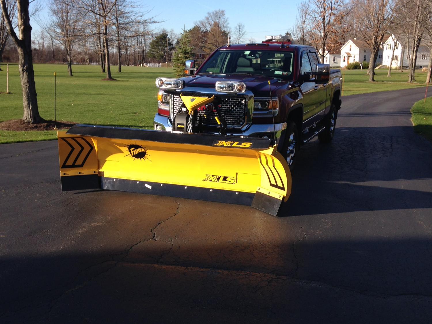

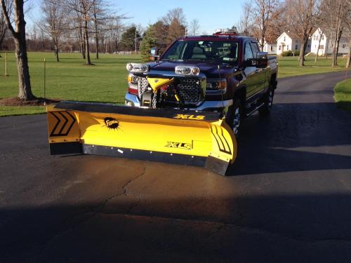

Depending on which plow you buy, you don't necessarily have to remove the valance. I use Fisher plows, and their mounts blend in nicely without hacking up the stock look.
I made it clear to my installer to not get lazy and remove the valance, or cut out more material than necessary.
They did a wonderful job, and cut very little.

Fisher Plows have instructions where to cut the lower valance and a small amount of bumper metal at the tow hooks area only, and the tow hooks remain - nice cleaner look -
I can show a pix if you like ...

With a Fisher mount, if you trim the valance, the push plate mounts are almost unnoticeable because most of the steel remains behind it and hidden.
