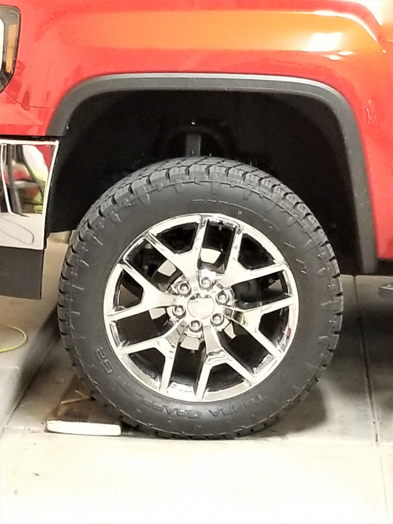

My 35s on factory 22s barely clear with 4" of lift, 2.5" level would require quite a bit of trimming9C9B6D6F-32EA-4FD2-8643-96E96B472A56_zps
Love the truck! What lift are u running for clearance to get your 35s under it? Any rubbing at all? And what exact tires are those?
2.5" leveling kit
.5" rear block on top of factory 1.25" rear block
1.5" zone body lift
22x9 OEM CK158s
325/50R22 Nitto Trail Grapplers
No Rubbing
