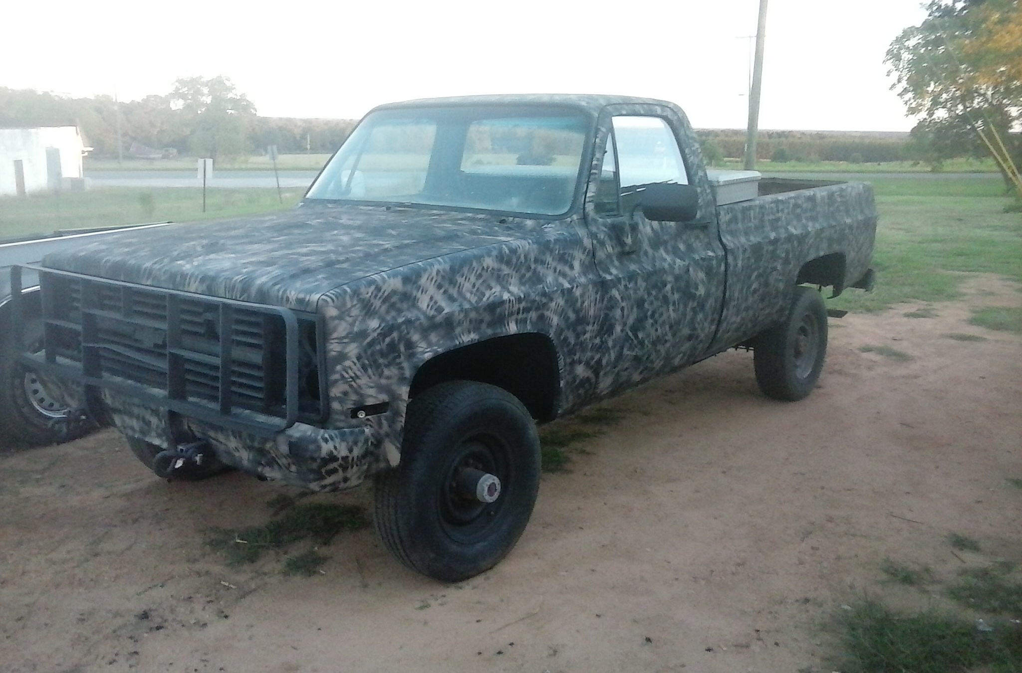

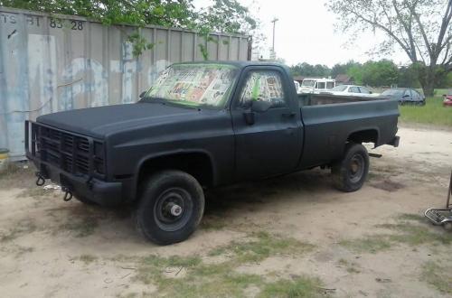

I'm looking for some suggestions on how Big of Tires can I put on my truck it's a M-10008 that I'm customizing myself I sanded it down for about 2 weeks and painted it flat black then I spray painted it my camo style, Re painted the inside Army, Ronald liner the floorboard and now working on doing all in interior, blacking out windows, bigger tires and i need some opinions if possible

they make big tires for the 16.5..
better off finding something else for wheel size, gets cheaper.
the gears are so short in the diffs, go as big as you possibly can fit, just to be a little more normal at highway.
maybe trim some fender for 35.
the back can go huge like every truck. Need to trim is up front.
I always wanted one, the m1009 especially.. 6.2 diesel.
33x what? An what rim should I go with I was told 15' but I have 16.5 rim now

For 3/4t trucks starting in '74 16'' rims were the most common.My suburban's spare is a 16'' rim.I had a '77 GMC 3/4t truck with custom 16''x10'' rims that are on my burb now.The tires are 305/70r/16 and are almost 35'' tall.When the rims were new they had 265/70r/16 tires on them and were 33'' tall almost exactly.
I have a pic if you'd like to see it,but don't want to invade your thread.
The rims that were on this truck were 16.5 when I bought it and changed to 16'' when I realized the choice for 16.5 tires is extremely limited.
