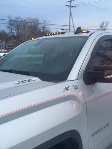

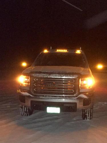

Put a set of recon smoked on my 15 2500hd and it was a joke for wiring,can't splice into the parking lights in the fuse boxes at all. Because it's all run by the body control mod.. So it wasn't easy so I just spliced it to the parking lights wire from the head light, so they don't work with my key fob but they work with the lights. Any suggestions on how to make them work ??? But overall they are bad ass I'll post pics soon

No they work perfect they just don't work with my key fog when u hit it they don't flash but they work with the light functions as they should because In order to make me come on with the key fob I have to figure out what wire that is on the body control module. So I spliced them to the parking light wire off the headlight and no they don't flash from the blinker. It's not easy as the older gm trucks because this truck didn't have them form the factory to start. The fuses in the blocks have power all the time for the wires to splice into such as the parking lights it's the bcm that controls that function

Sorry guys false alarm the cab lights work with the key fab when it is dark out but they don't come on in the daylight with the fab bc it doesn't call for the lights so they work great lol. I'll post pics this weekend :)
I used the recon harness I just spliced it into my parking light wire off the headlight because it's not in the fuse panels in the truck but it was a decent install about 4 hrs because we took our time and measured off a new truck to get the oem spots on the roof.
