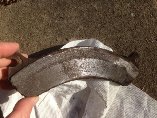

I changed brake pads on a friend's 2003 2500HD. 3 pairs of pads showed normal wear, about 20% left. However, the front left inner pad was shot and had an odd wear pattern.
The outside 1/3 of the pad was worn more than the inner 2/3 portion. Any ideas what would cause pattern, other than the rotor deformed that way, or just defective pad?
Also, one end of the pad (right side in pic) is worn more than the left side, as if the pistons are not applying uniform pressure across the pad. Is that common on these trucks?
We appreciate your help.
caliper pins sticking, or possibly the guides the brake pads rest in [at each end] are rusty and holding the pads to the rotor.
get brake grease to lube the caliper pins. and if they are sticking, maybe get a replacement kit including guides for the pads, and rubber expansion boots and rubber guides for the caliper pins [the rubber guides are way in the holes the caliper. lube the guides and put lube in the hole before installing the rubber expansion boot, as it tends to wipe the grease off before it gets inside.
Common on these Brake pads is the way they are made. The steel is "punched" and the Steel tabs that go in the spring clip 'guides" are a bit too big and the pads do not "Float" as the should when the caliper floats in and out as its supposed to. I ALWAYS bench grind the tabs some and lube them and test them to slide in and out in the clips before putting caliper back on. Better to have a tiny bit loose and work, than tight and grind the pad, or rotor and get the caliper sticking. Of course running "metallic" pads with this problem makes things MUCH worse . I always recommend a FULLY Ceramic pad. ( not a "blend" ) ..
