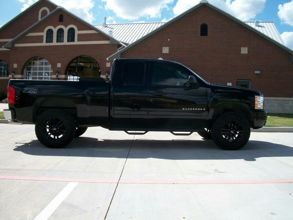

Coastal44 Posted March 24, 2016 Author Posted March 24, 2016 Thanks for the reply huntr. Do you have a picture? I didn't think to subtract the stock blocks, but that makes sense now.
huntr1117 Posted March 24, 2016 Posted March 24, 2016 Thanks for the reply huntr. Do you have a picture? I didn't think to subtract the stock blocks, but that makes sense now. Here's an old pic. Sent from my SAMSUNG-SM-G920A using Tapatalk
Coastal44 Posted March 24, 2016 Author Posted March 24, 2016 That looks nice!!! I'll go with the 3" blocks. Thank you!
