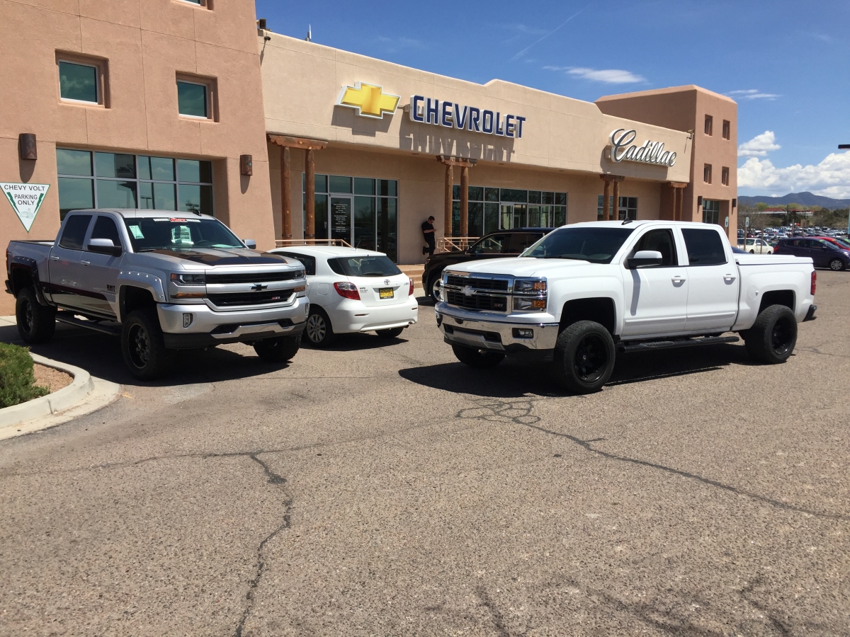

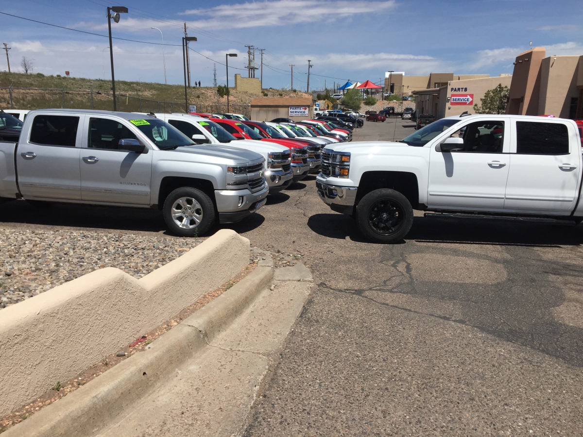

Z71dude15 Posted April 24, 2016 Author Posted April 24, 2016 Here's her next to a factory 6" lifted truck BEFORE I took the leveling kit out today. Wish it would have worked out loved the look

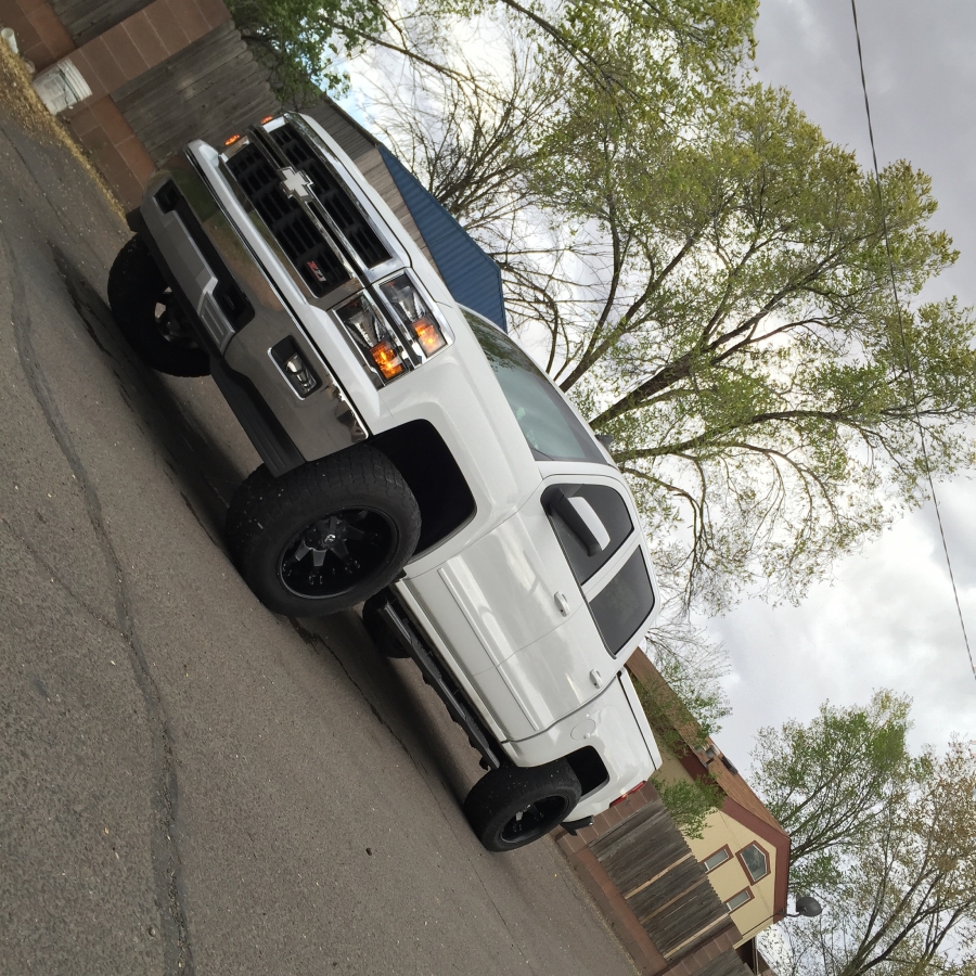

Z71dude15 Posted April 24, 2016 Author Posted April 24, 2016 Once again before I took the spacer out today
