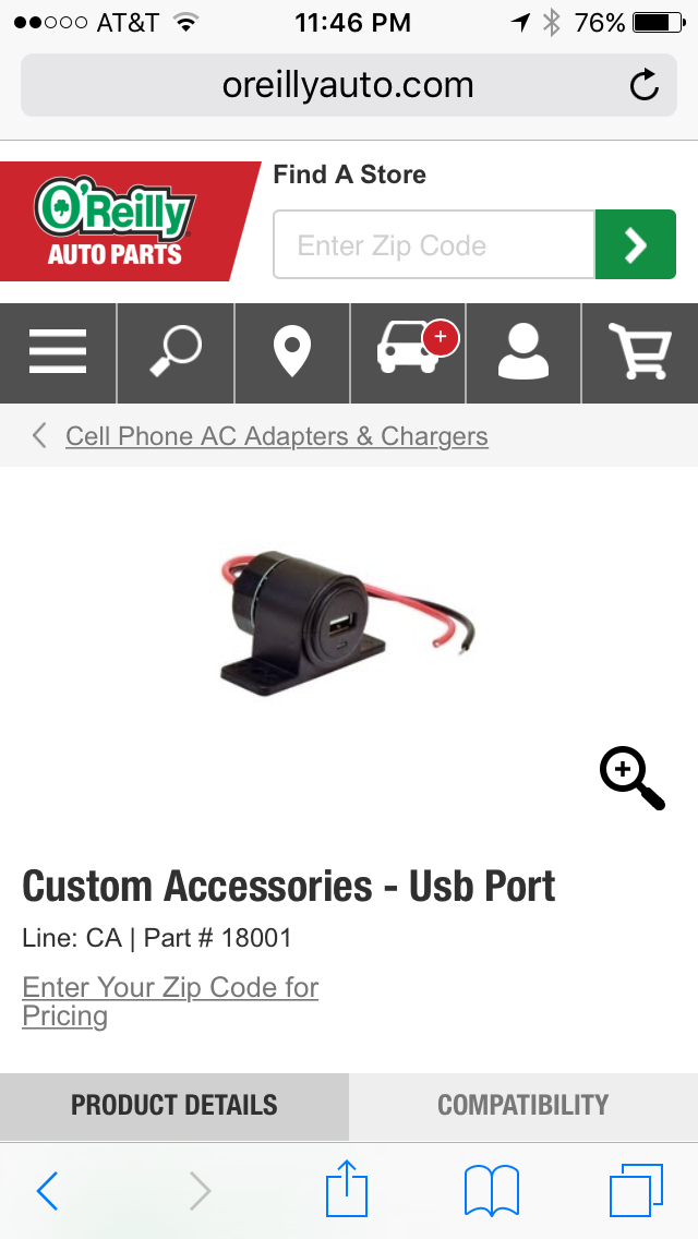

So here is the wireless charging mod in the center console lid. Cost less then 60 bucks if you know were to buy stuff. I have attached what you will need. I havn't got my charger in yet to show that install but I've done the first part.
Once you get the flush mount usb charger then you will take it apart.. I wrapped the ends to protect the connections from coming loss. then you will crimp the t-tap females to the ends. in the back seat you will start from the bottom passenger corner of the console base and start popping the plate off. I used my hands there just popped in.
once I got the plate off I cut back the lum to expose the wires, then I crimped the t-tap splices to the wires red go to the purple wire and ground goes to black.. connect the wires and done you have a working usb charger. to verify that it worked I used my usb phone charger and it charged. also it you buy the part I supplied it has a led that will come on.
NOW REMEMBER WITH THIS ACC PORT THE TRUCK MUST BE ON. all that will be left is to take apart the wireless charger and mount it under the rubber pad and run the wire I will try to remember to take pictures...
