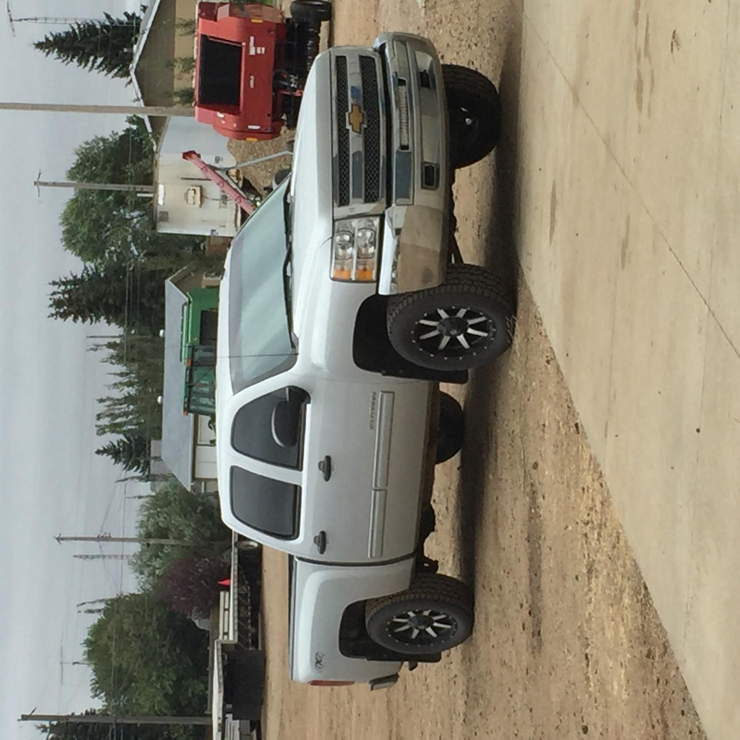

When I get the wheels and tires on I'll post a picture!
