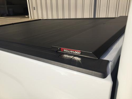

Well I went ahead and got what I was initially wanting. Roll N Lock A series. Here's my take on it with some pictures.
Love the look and feel of the cover. Overall it is a very nice and solid.
Took 3 weeks to get, whether that was them or AutoAntything who knows. At time of purchase was a free cargo manager. Waiting on it.
Installation was pretty straight forward...on the 3rd and final tweak and adjustment. Opens and closes very easy, might be slightly heavy for "girls". After this I could install one much easier and quicker on the next as goes things like this. Watching the video helps.

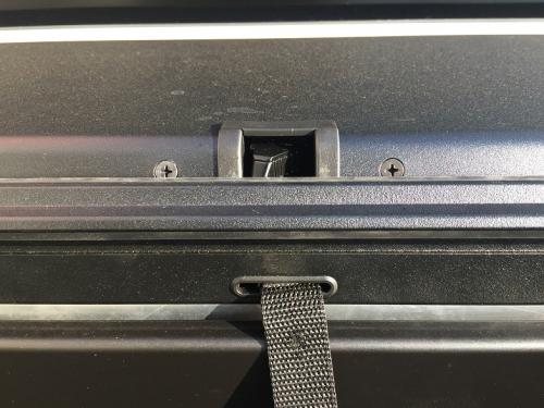

Minor Installation issues that arose were
1- clamp screw went up between plastic bed cap and of the bed itself. No big deal, just be aware. see picture
2-Main clamp on container slipped down while screwing in set screw. My fault, not snug enough on clamp. Had to remove side rail to fix.
3-Be aware of rail overlapping tailgate with potential rubbing.
Had to trim bed liner and tailgate liner, that ahead of time though. Tinsnips work pretty good.

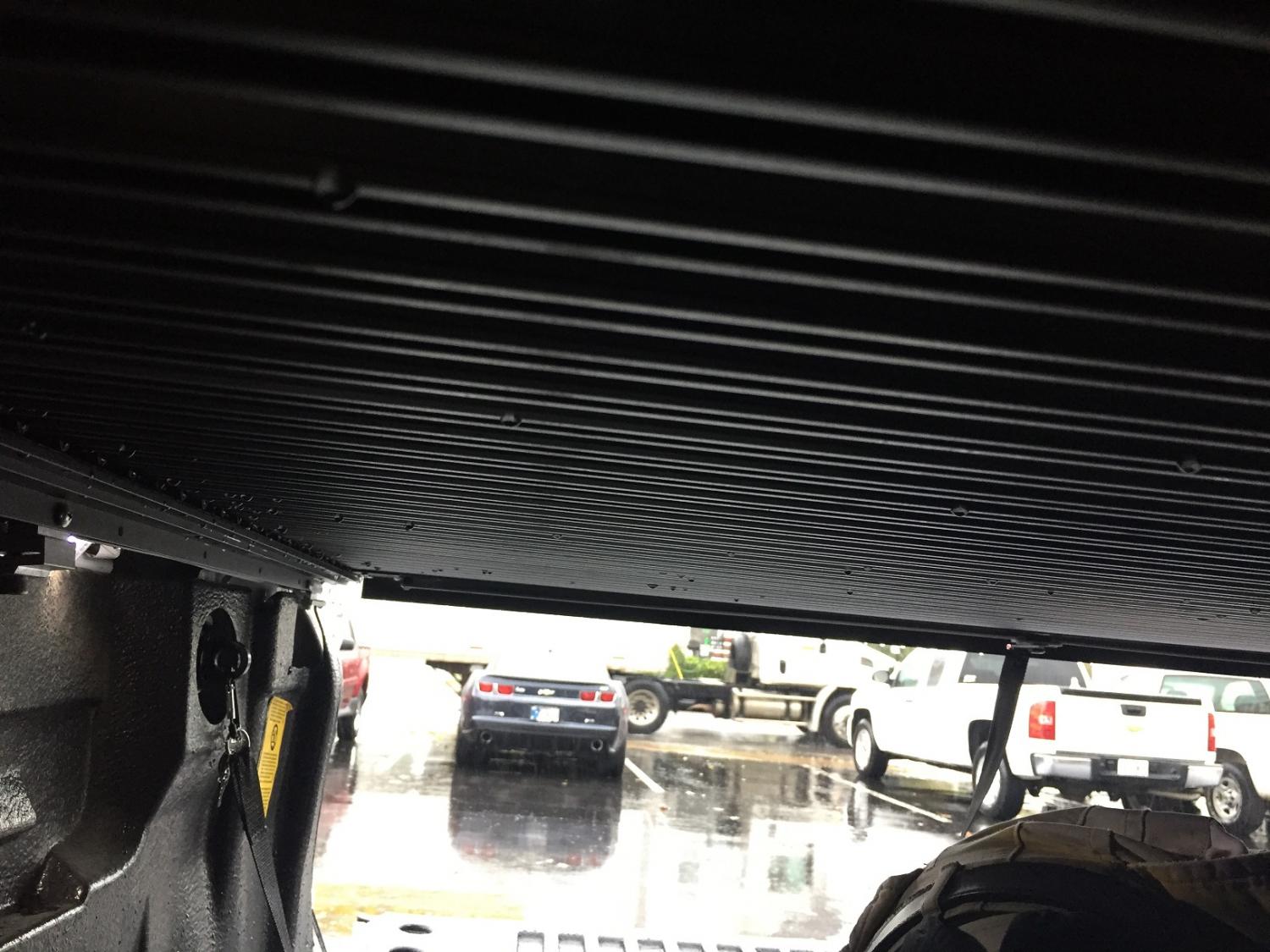

Cons would be.
1- she leaks slightly more than I thought, I may be able to tweak on a couple of those. Although it was a downpour. see pictures
Through a car wash it wasn't so bad.

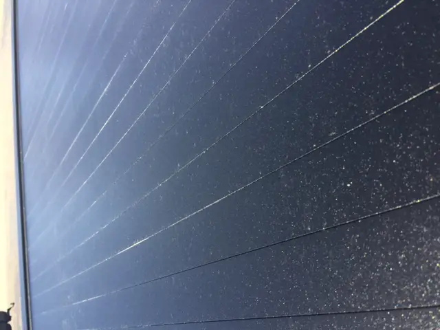

2- the slats appear to let water seep into the cracks - see picture
3- just noticed this today, I believe it is soap residue from washing showing in the cracks, need to rinse better. see picture.
I didn't want a vinyl cover because of long term care of it but these were some unexpected things with the aluminum slat cover.
