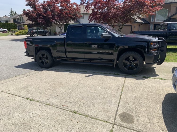

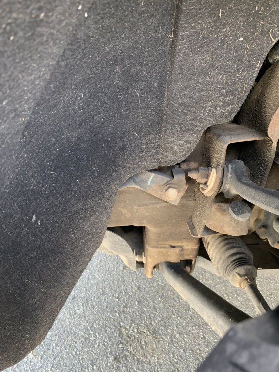

I have a 2016 silverado 5.3 with NO level kit and i have test fitted many sizes at the shop and the largest you can put on is 285/60/20. There is very little trimming and no rub.
