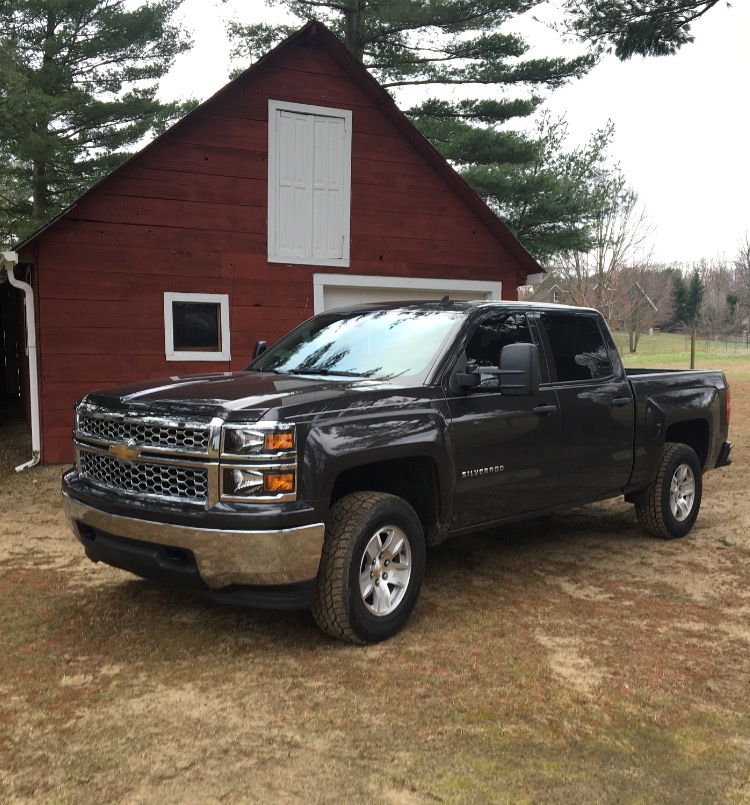

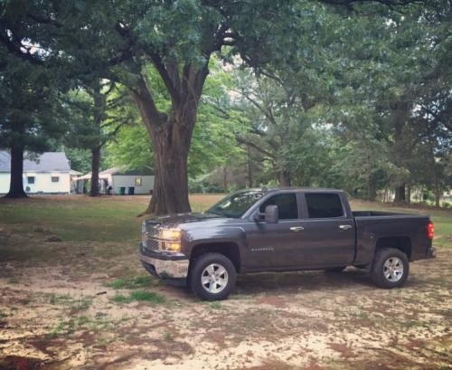

I really like the way your truck sits, did you use tapered or flat lift blocks.

Not a problem, I used the tapered blocks. That's the best way to go

p.s. If you have anymore profile pics of your truck I would sure like to see them.
